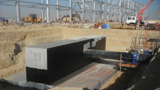

The F team.
500 ton pipeline anchor block.
Impressive, I guess you don't just lay it on the floor = )

That's the biggest pipeline anchor that I'd ever seen. Weighs 500 Tonnes.
Why so chunky at that particular place?
Not even Allah knows the answer to that.
It's a waste of good concrete.
