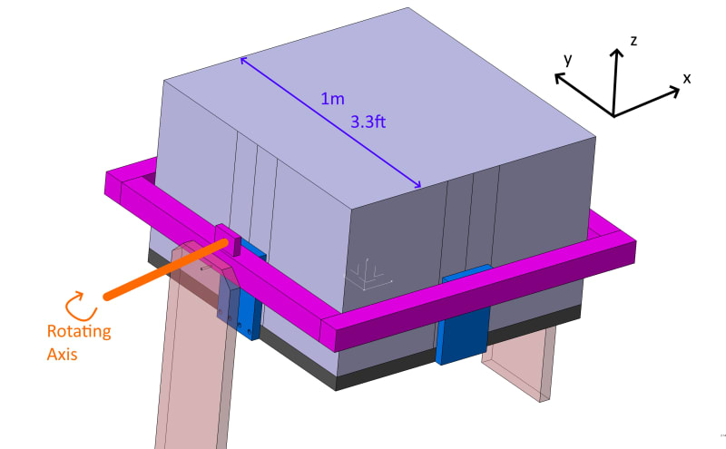

We have a load on a plate we want to turn by 90º. What is the best way to do this?
I thought about using gears. Here the general idea:
We have this grey plate in horizontal position:
We mount the load on the top (just a block to simplify the representation):
We attache four supporting plates (in blue) on the original plate to get closer to the center of gravity:
A frame (in pink) around the system connecting all blue plates is placed:
Two stands (in transparent colour) are installed:
Then comes a pillow block bearing on the stand and a spur gear which is attached to the pink frame (there was a square hole). The shaft is in the center of gravity
And finally a small gear with a cranked handle on the stand:
I didn't calculate anything yet. First validating the idea, this is the easiest way I came up with to turn this
What do you think?
Yes, the idea is having the rotating axis in the center of gravity (or as close as possible, since it is a very heterogeneous load, difficult to estimate).
There are also many cables and pipes under the grey plate, that's why we have the frame around.
I didn't mentioned but the weight is ca. 1 ton
thanks

That's a bit of torque 167 ft*lbf; you'd need at least 20:1 gear ratio, assuming a 1-inch CG offset and an 8-in crank --> 5.6 ft*lbf
one rev per second --> 0.01 hp, ignoring mechanical losses.
TTFN (ta ta for now)
A screw jack wold b self-locking.
I'd consider using a self-locking worm gear set instead of the spur gears.

There is a "delicate" content in the box, it has to be carefully turned. We can't pivot it on an edge.
Here a more complete picture:
We rotate around the x axis. The box is ca. 1x1x1 m3 (3.3x3.3x3.3 ft3)
As you mention, a worm drive self-locking is much better idea: a safe, soft moving turning.
First we mount the lower plate on some base, then we put the box (the box is a representation, there are many complex things inside). After that we assembly the turning setup around it.
This will be moved once per year or so. The final position is with the grey plate vertically. We start horizontally to ease the "box" mounting procedure
thanks
The biggest Issue I se eis a massive increase in load on the side of the box when vertical.
At horizontal, whatever weight or mysterious things are in this box is spread over your 1m x 1m gray plate. Once vertical all the weight looks like it will be spread over the size of one of your little blue plates as the blue plate is fixed to the grey plate. Also at certain angles there will be a lot of force on the bottom corner of the box between the blue plat and the grey plate.
And what stops is tipping out if the CoG is ever so slightly out of the axis?
Also the Cof G will need to be the entire assembly, plate, blue and pink bits plus the box. Difficult to see that being uniform.

I am assuming there will be thrust bearings under the grey plate to reduce friction, then a worm gear set to slowly rotate in the x axis.
this would help with the center of gravity. a safety locking mechanism to help support and lock in place in addition to the worm gear drive.
and electric motor could be used to rotate, problem with worm gearing it would have to rotate in both directions,
I would stick with a spur gear with standard off the shelf products.
There is a mounting and a working position. Mounting is horizontal, working is vertical. We have to come up with a system to make the change, even if it is expensive/complicated.
In principle I am thinking about rotating it by hand, it's just 90º and not often. The idea is using bearings to take the weight and allow the rotation. I like the worm drive idea because of the self-locking option, I am seeing not all worm drives are self-locking, we will need additional blocking elements

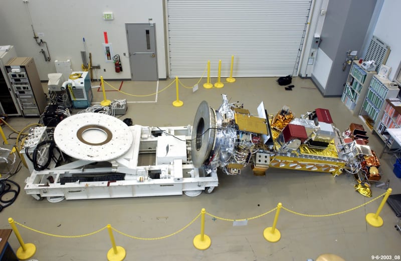

Don't come up with anything, buy a weld positioner.
You can get them in any size from small to gigantic.
You could even drop a satellite off one if you forget someone undid the bolts
