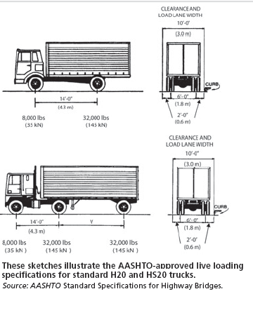

The truck width is fixed at 10', and the wheels are 6' apart, so when position two trucks, the wheels can get as close as 4'. I don't think you have problem with lane load.
@retired13
Can the axles move between the 10' loaded lane (1', 6', 3') or do the axles have to be centered within the 10' loaded lane (2', 6', 2')?
The 10' wide truck (body) can be placed at any location in the 12' traffic lane, but the truck bodies can't overlap. The wheels are fixed to the truck body, so they follow the truck position, the most close position of two trucks' wheels, therefore, is 2'+2' = 4'. Make sense?
Yes, it makes sense now.
I didn't know the 10' loaded width was the truck body attached to the 6' axles.
Originally I thought the 6' axles could move within the 10' loaded width, but i guess i was wrong.
Thank you for the clarification.

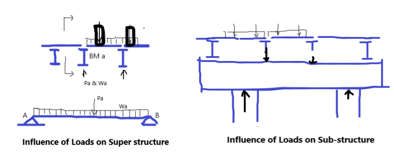

I think the difference between arranging traffic loads for super structure and sub-structure can be expressed as follow:
Supper Structure - Bridge Girder
- So arranged to produce the maximum load to be carried by a "single girder" in the longitudinal direction (see sketch).
Sub-structure - Pier, Abutment
- So arranged to produce the maximum load (P) and/or effects (M, V, T) to be resisted by the element under design.
Hope the above helps, though more elaboration/example is required, especially concerns for the substructure.

I also agree on the difference when designing the superstructure and substructure for live load (transversely). Believe it or not, that picture explains it in a simple manner. I guess the saying is true "a picture is worth a 1000 words".

Glad that my cartoon worked :) Have fun to join the bridge world!

Didn't look in detail here. How's come you are using truck body width a 10 feet when the legal limit is 8-1/2 feet?
AASHTO standard truck to be placed in 12' wide drive lane.
