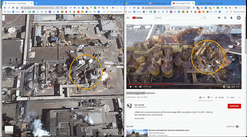

I didn't see a readily apparent ruptured vessel in the flyover.
Did I miss it or has it "Left the building".

I think that debris has collapsed back onto the vessel that blew.
I wonder if there was a section of head launched with that explosion?
There looks to be very little damage to adjacent equipment and structures.

Looking at the mill on Google Earth, there are two tall slender vessels at the blast site.
At 1:12 of the flyover you may see one of the vessels leaning and the second vessel lying on the ground.
Other views of the leaning vessel show the top missing.

Thanks for the images, IR.
