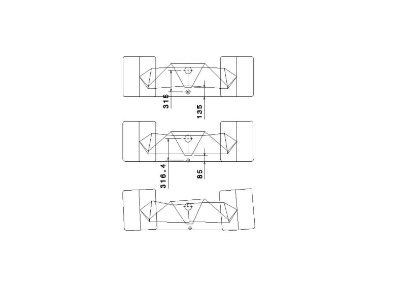

I prefer to join you a picture of the suspension I mention (sport car , formula ford, etc). It is 2d example, not 3d, but a good start.
Formula 1 is not interesting, because wishbone are placed for aero reason (mainly at the front).
You mention instant center movement, but I never mention IC movement, I understand your thinking: for no roll center movement you need no IC movement.
I only mention distance from roll center to COG keep the same.
If you have an example of suspension to submit me, and if you leave me one point free, I will be happy to show you that it is possible to limt near minimum , roll center movement regarding COG.

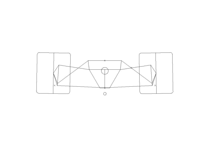

I don't have a method of creating an illustration and posting it here.
Now ... Take that diagram and draw in the instant-centers. I'm going to guess that the instant-center of each side (where the projections of the control arms intersect) is about 1 vehicle-width on the opposite side and close to ground level.
Then ... Lower the bodyshell by (let's say) 50mm and re-draw your instant-centers. They'll be below ground level.
Then ... Go back to nominal ride height and re-draw with 5 degrees of body roll. It's quite possible that the instant-center of the outer wheel could end up pretty close to ground level. I don't know where the inner one will end up but given that the arms will be going closer to parallel, it's likely to be far off to the opposite side of the car. But we don't care much, because most of the weight is on the outer wheel, not the inner one.
So, you have fairly low vertical motion of the instant-center of the outer wheel (the one that matters) in roll (and we don't much care what the inner one does), but you have considerable motion in two-wheel bump (it goes below ground level).

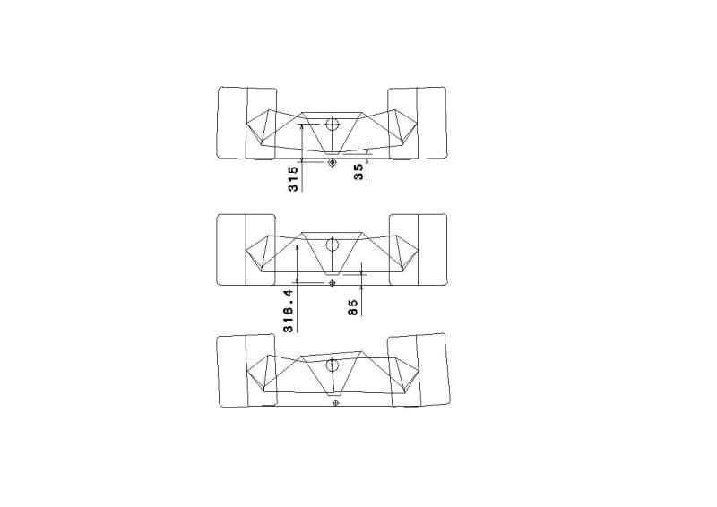

So what I say is: I have a method to construct a twin arm suspension wich minimize RC-COG distance, I posted below an example:
upper figure are +-50mm travel
middle figure is static
lower figure is 5° roll
same wich Ic drawn
Ic is moving but RC-COG alter of 3mm
The big picture is: I create a program calculate every force on suspension element under lateral and vertical acceleration, wich give me a good idea of what happen in a steady state corner (roll).
I find a construction to design parallel twin suspension with small RC-COG distance variation. I did not see any interest of this with my program, but I have the feeling that it could be a plus in dynamic, so I ask if somebody had always tried a twin arm suspension with small RC-COG variation, and if yes what was the result?
Your first diagram isn't what I meant. You drew the left side 50mm into bump and the right side 50mm into rebound. What I meant was the situation where BOTH sides are 50mm into bump, or BOTH sides are 50mm into rebound. You should find that the former situation places the roll center below ground level, and the latter situation places the roll center above ground level.
Lots of race cars - practically all open-wheel race cars - have been designed with suspension generally like what you are illustrating, which has relatively low instant-center height movement in roll. For that matter, lots of street-driven cars are like that, too. And it's been done since the 1950s if not before.

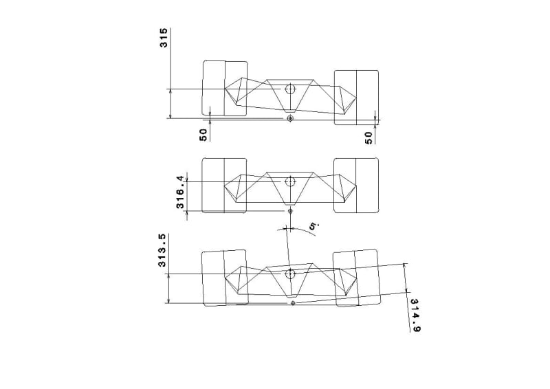

I DRAW the diagram as you asked
ride height -50 from static
ride height +50 from static
So Rc to COG distance alters by 1.4mm.

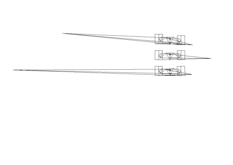

I did not DRAW the IC line, I can do but it will make small picture difficult to read.
I can sent you the file (dxf, dwg) and you be able to control by yourself that I did not cheat, and I know how to DRAW a roll center.
On my previous post, I draw one side +50 and the other -50, as far as it is symetrical, I put on one wiew 2 cases, may be it was not clearly understandable for you.
