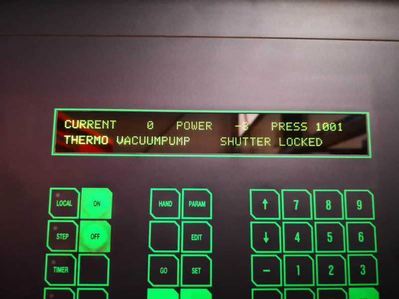

Thermo vacuumpump error
check for all three phases at the circuit breaker/thermal relay for the vacuum pump. Disclaimer- don't electrocute yourself. reset the breaker/thermal relay
Chris Krug Maximum Up-time, Minimum BS
it's circuit breaker Q1 in the top back of the laser cabinet. Make sure you have all three phases. The turbo and everything else will run on single phase in some conditions.
