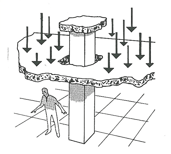

Quote:
Punching shear is a phenomenon in flat slabs caused by concentrated support reactions inducing a cone shaped perforation starting from the top surface of the slab. Although generally preceded by flexural failure, punching shear is a brittle failure mode and the risk of progressive collapse requires a higher safety class in structural design.
Quote:
One way shear is rate of change of bending moment. It's typically called beam shear. However two way shear is punching shear and its effect is two way. It's also called flat slab shear.

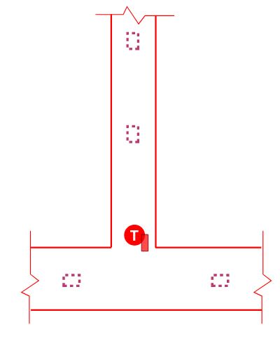

Thanks for your responses; I've attached a sketch to show a particular condition i'm worried about.
The location of the column transfer means that there is definitely enough room for the punching perimeter to form. This leaves me with a few questions, sorry if some of these are obvious answers:
1. I'm also going to need hanger stirrups at the beam intersection; is this in addition to any required punching shear reinforcing? Does anyone have detailing suggestions for this?
2. I have a thin slab outside of the transfer beams, but is there any reason I would need to treat this as an edge condition?
3. If I do need stirrups for punching shear reinforcing, i cant extend this 2d from the face on all sides, as I run off the beam. Does this mean I must widen the beam, or as i mentioned above, does this create an edge condition.
Thanks very much for your help!

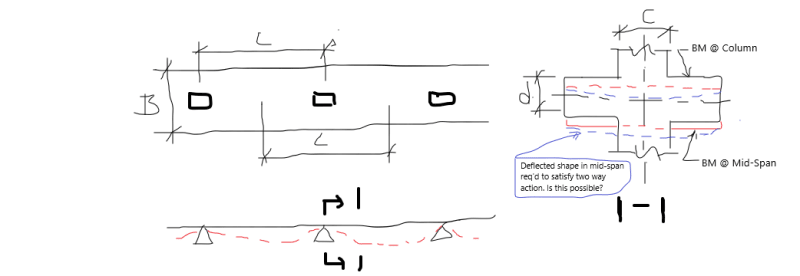

I hope the sketch below can help you to realize the difference between one way and two way actions from deflection point of view.
I don't quite follow your question. Can you provide a cross section on each beam, and show where is the slab of your concern?
