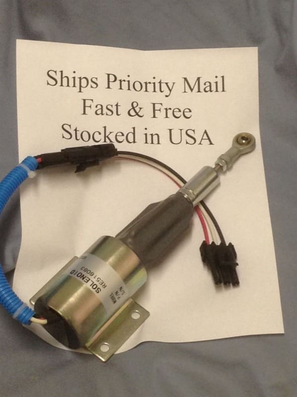

This 255kW Volvo based generator has a fuel solenoid bolted on the side of the engine block. It's at an angle, if I recall correctly. It's silverish-pinkish and about six inches long, two inches in diameter. This is all from seeing it about last October.
It has three wires going to it. Why?
Whenever the system is turned on the wires promptly melt clear back to the controls. Apparently the wires melted so it was assumed the solenoid was toasted so they replaced it. The wires promptly melted again. Any ideas?

That vintage engine could have one of two style fuel solenoids, pretty much as Bill described, both were three wire, in the diagrams they are usually called out as,
Ground
Pull
Hold
On the style with an internal switch, usually the contact is on the inside of the solenoid body, most common problem when they burn like that is that the linkage is not coming back far enough to break the pull in coil contact, so your "electrical" problem could actually be mechanical in nature. If you pull the solenoid plunger out of the body you should be able to see the contact pin. This style is usually the longer of the two and most I come across are made by Bosch or Dynalco, and most are branded with the engine manufacturers name and part number
On the style with the external switch, the pull in coil was usually wired to a relay that is energized when the starters crank, so while cranking the pull in coil is active, and the hold in coil is controlled by the keyswitch or genset controller. This style is usually shorter than the one with the internal switch.
Hope that helps, MikeL

Keith,
Take a look here,
Pretty much all the smaller engines that use an ETR (Energize To Run) fuel solenoid with external relays use a connection like this. So other than the color coding the wiring function will be the same. Not sure which wire is which? Best bet is ask the supplier for a diagram, if that doesn't work then use an ohm meter, the two coils will have a large difference in resistance value, a little bit of Ohm's Law applied will tell you which is the Pullin vs. the Holdin coils. Also in newer versions of the solenoids by many manufacturers the pull in coil will have an internal flyback diode.
Another problem that crops up in these a lot is the relay used for the pull in circuit, usually a small Bosch relay but its contacts are rated for 30 amps, the relay fries and someone grabs a similar looking relay without paying attention to the contact rating, it fries and then someone start jury rigging wiring to make it work.
Hope that helps, MikeL.

Mikel; Thanks. Sounds about right. Internal flyback.. Had no idea. This thing is at least 20y.o.
I think this is what it looks like and even has RED/WHITE/BLACK wires. But, no connector.

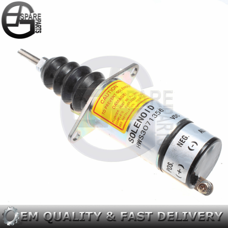

See if you can find a 24 Volt version of this.
This is on Ebay.
The cut-out switch is internal.
COMPARISON.
Internal cut-out switch: If the internal switch fails, replace the solenoid and done.
External cut-out switch/ circuit: If the external circuit fails, solenoids will fail as fast as they are replaced until the cut-out circuit is repaired.
