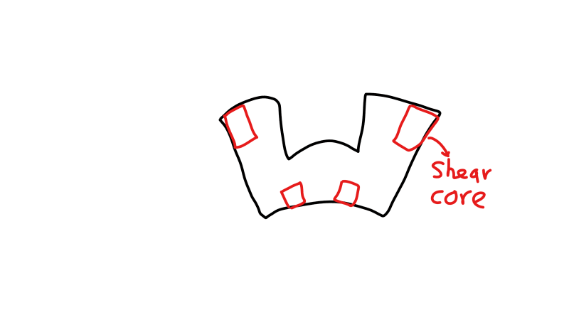

My piers are not orthogonal to the X- and Y directions because the building shape is curved in plan, kinda like the example below:
I understand that the exported pier forces will be the in-plane for each individual wall.
So that means i need to resolve those back into X- and Y-components right? It seems a little bit troublesome because in our case we have a very big development many shear cores. But if it has to be done then it has to be done. I'm mostly doing it as an internal exercise to gauge how much shear force they are resisting, but anyway I will see what happens.
