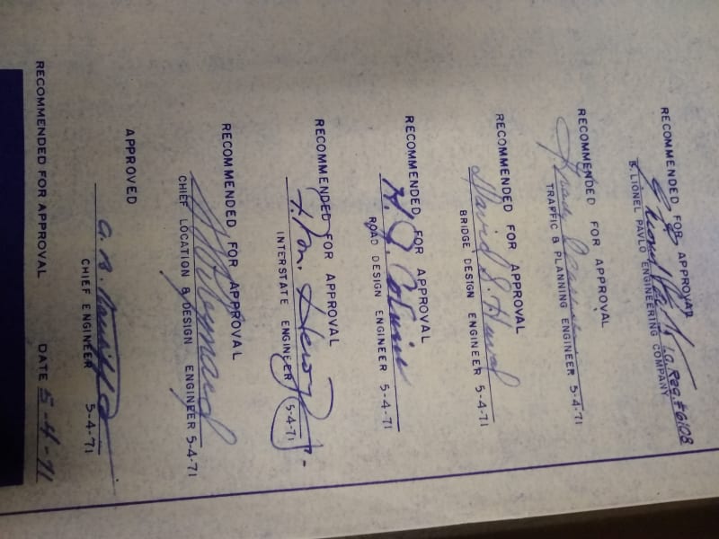

When I opened your attachment the first thing I said was "OMG! Vicksburg". I worked for Dr. Pavlo from 1981 until his death in 1989. After 40+ years in this business, Pavlo was still the best place I ever worked at. As an aside, Vicksburg was the prototype for the Silver Memorial Bridge between Point Pleasant W VA & Galiapolis OH. Anyway, sentimentality aside, I was thinking along the lines of David, adding a tab plate, see attached sketch. It's based on a similar detail we use on some NYSDOT projects with 18"x18" scuppers.
If it's not too much trouble, could you tell me the names of the people on the drawing? When I worked there, some of the Vicksburg crew were still around.

Bridgebuster:
Designed by: G.T.
Drawn by: E.W., A.S.B., S.K., E.C.
Checked by: N.I., Y.C.C.
Revisions: A.L.P.
Can you say "rubber stamp".
It wouldn't be the first time people accept the information about the material listed by the drawing at face value.
Best regards - Al
The drawing is calling out the scuppers as A536 Grade 65-45-12 "cast steel", but that ASTM spec. is for ductile cast iron. We buy a lot of parts made from that material. Ductile iron can be welded, but it's tricky, and some foundries have the chemistry control to do it, others not so much. You risk hot cracking every weld due to the high carbon content. Bronze tig brazing would work well (at least, it does for us).
Thanks osoloco. I recognize 4 names.I worked under GT on the design of the bridge over the Mississippi River at Gramercy LA; cantilever truss. One day I'll take a drive to see it and Vicksburg. I have a friend in Jackson that I've been meaning to visit.
My experience is that the more signatures a document has, the less it has actually been reviewed and the more likely it is to be deficient. Six (6) signatures is the mark of an overwrought and unwieldy quality system.
I advise against showing the names of people who don't know about it.
