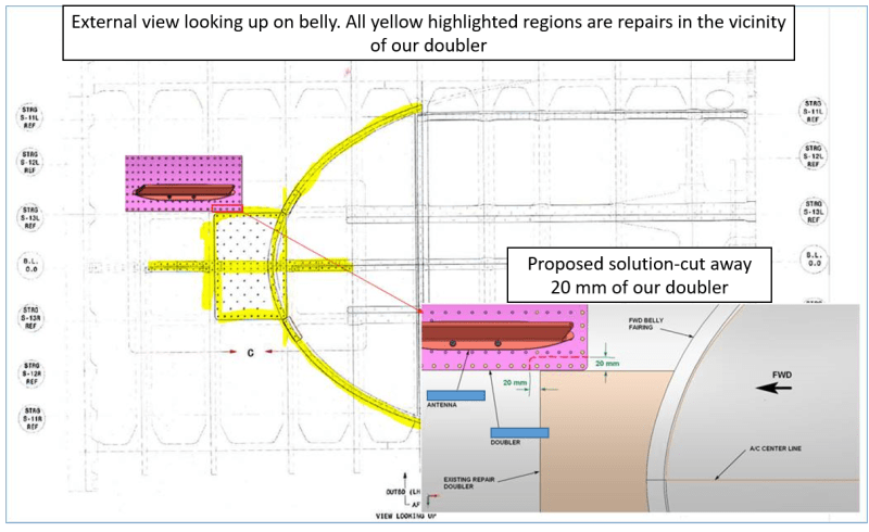

Valid points made about the altered stress field in the skin due to the many repairs. I attach a sketch of the problem and would love to know everyone's advice and thoughts further.
To clarify things, I'm working on adding a small antenna to the belly of the fuselage. We are not the OEM, so I am basing all analysis on conservative assumptions. The doubler is there to carry the antenna loads to the adjacent stringers/frames, and to reinforce the 1" skin hole for the system cable. Due to large-scale corrosion on the a/c (7500 Flight Hours and 5000 cycles), the OEM performed massive repairs on the skins/frames and stringers. This leaves us not too much room to attach our antenna. The sketch shows a suggestion to cut away 20 mm of our doubler, but is that enough?

Is this pressurized structure? Is this an STC?
Regarding your statement: "The doubler is there to carry the antenna loads to the adjacent stringers/frames"... I would not rely on the doubler as the load path for antenna loads to the substructure. If there are significant antenna loads you should have intercostals etc. Looks like a small antenna, so I'm not sure exactly what you need. But I would only consider the doubler as reinforcing the cutout.
Now, those doublers are encroaching on one another. If this were my decision I'd say remove the existing repair and incorporate the previously repaired area into one doubler including the antenna area. Extend the periphery of the doubler at least one row beyond the existing repair holes.
You will need to analyze the effects of the new doubler configuration on the underlying stringer repair (which has fasteners c/t the skin reinforcements).
Now most importantly...who is approving this and have you been talking to them?

Whats the inspection regime for the existing repair, is it acceptable if that ends up being applied to your doubler?
Is the existing repair doubler thickness = > full skin thickness, the repairs fastener detail isn't what would be considered industry practice. If that is the case that would mean you can review your fastener number and pitch assumptions.
Guess you have check the intended antenna location for any small skin blendouts?
Possibly you could split your doubler into an inner and outer to get more flexibility in the layout.

This is a pressurised structure, and an STC. It's a low aspect ratio antenna, so the skin/doubler combo panel can handle the out-of-plane bending loads, even superimposed with global loads. Is replacing the doublers with one large doubler the only viable option?
verymadmac, the skin and doubler are 0.032" and 0.05" respectively. Not sure what an inner doubler would solve...
why are you adding a dblr ? a low profile antenna shouldn't introduce big loads into the structure. even if you have a large (like 3" dia) hole and you don't (having read your posts again !?). you may find a better solution is to live with the Kt and to have a simple (visual) inspection of the hole; as opposed to a much more complicated NDI inspection of the dblr.
A part23 a/c will probably have a very low hoop stress, something like 6psi*36"/0.04" = 5.4ksi; so this says that the resulting inspection with Kt = 3 should be ok.
I'm not saying it is the only viable option, but it is the one I would want to move forward with if it were me. Since this is an STC, I am assuming the STC Holder / ODA / a DER is involved in the approval process. I would ensure they are on board with everything.
There is a study of skin stress effects due to doubler proximity in AFRL-VA-WP-TR-2000-3030, Appendix E. However, these doublers are not just in proximity, they are butted up against one another. Even if the stresses are low, there are eccentric bending stresses in the skin primarily near the doubler outer rows. Having the doubler edges like that will create complex stress details in the skin which will be hard to predict. It is a poor stress riser detail and also poor from a damage tolerance standpoint. I'm not sure why they would not be encompassed together if given the opportunity
Also, since it is an STC, you need to re-evaluate the static substantiation and DTA for the STC in general, since this aircraft no doubt deviates from the intended STC drawing installation. So it's not as if your analysis will be any more complex. If you combine them it should be simpler actually.

I'm mostly supportive of the comments you've received from LiftDivergence. I've done a number of antennas just like this one, and he's covering a lot of it.
Two ways this could go:
You "should" be willing to combine these doublers because it is structurally more efficient and easier to substantiate,
OR
You "should not" be willing to remove the existing repair because it's subject to SID's or something else that would be awful if you touched it.
Do your research.

You always want to get your approving authority on board with your plan BEFORE you carry out the plan. If they've done an antenna patch before (and why would you be going to them if they hadn't done this kind of approval before?) then they must know what they're looking for. If they aren't happy to tell you, or you're afraid to tell them too much, well, I can give you MY phone number and we can do business.
There is no way in **** I would allow two doublers to be butted up against each other like that on a pressurized shell. Nor even remotely close together.

Doublers should be symmetrical. Not much point in having more rivets on one side than another, unless there are underlying structures that have to be matched. Doubler spans 3 bays, but there's probably only 1 (maximum 2) connector holes and a few screws in just 1 bay. It does not appear to me that you know what purpose your doubler serves.
Why can't this antenna be mounted 6 inches further to the left? (up in the diagram)

I also missed the attmt. I think the proposal worse than butting the dblrs, not that I like butting dblrs. My preferred approach (given that I cannot make the two dblrs into 1) would be to butt the dblrs and add an external splice, 4 rows of rivets (2 on each dblr). The next important detail is where are the stringer rivets ? If along the original dblr, then I'd pick these up with the new dblr. (There are two schools for this, to either terminate the dblr on the stringer rivets or off them; these two schools are as divided as Catholics or other religious denomination and Atheists !)
