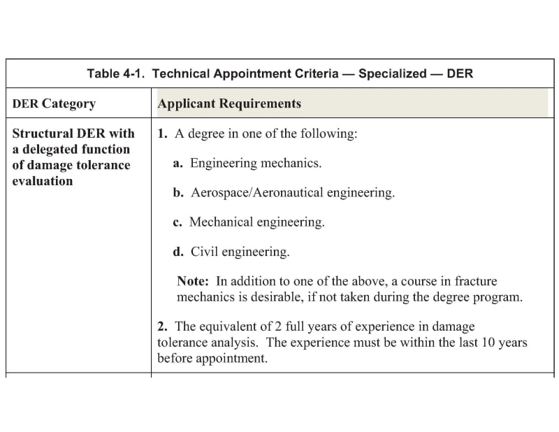

SparWeb, I would partially disagree with the assertion that getting DT authority is harder now than 20 years ago. Current requirements are in Order 8100.8D (10/28/2011) Table 4-1, page 4-7:
This reads the same as Order 8110.37C (9/20/98), before appointment requirements were moved out at 8110.37D (8/10/06) into Order 8100.8. Order 8110.37B (11/12/96) changed the damage tolerance analysis experience requirement down to two years, from seven. My expansion of authority was done when Notice 8110.49 was in effect, in 1994, which had the highest requirements of all: eight years analysis experience and specialized course required, not ‘desirable’. Before Notice 8110.49 (which is NOT software Order 8110.49), Damage Tolerance DER’s were appointed/expanded on Tom Swift’s say-so. That would certainly have the appearance of being ‘easier’ than now. As far as other appearances, it only extended to two individuals, one of whom was his mentee/my mentor. But he was still consulted for my expansion, ACO’s continued to contact him for several years before switching over to doing DT DER appointments and expansions by the Order. It was never an official part of his job.
