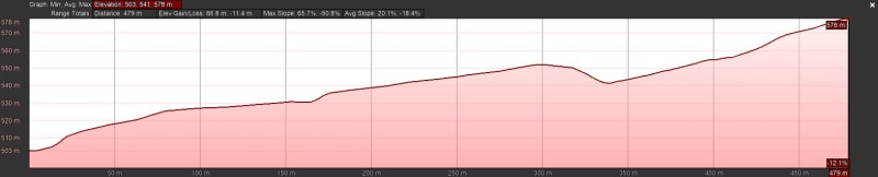

2) To be confirmed after Monday, but I have attached an image below which shows the elevation profile of the straight line from the lower to upper tank - I'm fairly sure (but will confirm 100% in a few days) that the pipe follows this route, or a close approximation to it.

Here's what's on my napkin:
This is the USA you're working in so we'll change out of metric.
Static head: 77m x 3.28 = 253ft Vertical
Lateral Distance: 480m x 3.28 = 1575ft = Lateral
Hypoteneuse = 253ft + 1575ft = 1,600ft Pipe Length
1000L/hour / 227gal/min = 4.4gal/min
The flow sets the pressure required for any particular size pipe.
Friction Pressure required using 3/4" PVC plastic => 70ft of friction head | velocity = 2.8ft/s
Friction Pressure required using 1" PVC plastic => 21ft of friction head | velocity = 1.7ft/s
Friction Pressure required using 1-1/2" PVC plastic => 2.5ft of friction head | velocity = 0.7ft/s
Working head with:
3/4" PVC = 253ft + 70ft = 323ft = 140psig
1" PVC = 253ft + 21ft = 274ft = 119psig
1-1/2" PVC = 253ft + 3ft = 256ft = 111psig
Pumping requirements assuming 75% pump efficiency and 90% motor efficiency
3/4" PVC = 0.48HP into the pump. 0.40kW into the motor
1" PVC = 0.41HP into the pump. 0.34kW into the motor
1-1/2" PVC = 0.38HP into the pump. 0.31kW into the motor
A typical solar panel is about 250W but at 9A and 28Vdc. Two panels gets you about 500W. The worst case 3/4" pipe setup would likely need about three panels while the 1" and 1-1/2" PVC pipe lines would probably run with 2 panels.
There is certainly more to do in regards to how to get from the solar source to what the pump needs. There are many ways to achieve it but it all depends on the details we don't have. You also need to have a way to stop the pump at the bottom of the hill when the tank is filled. Choices are; letting it run out on the ground. A wire. A radio transmitter and a receiver at the pump.
If the existing pump is old it may make sense to get a new solar pump system. If it's newish then you need to convert the solar to whatever power the pump needs. There can be some losses involved which might reasonably be expected to up the panel counts by one.
If the pipe is steel or smaller or ??? it would change everything.
Folks, do my numbers look reasonable?
Or as Artisi suggests below these smaller pumps are less efficient so these numbers with a 50% efficient pump would change to:
Pumping requirements assuming 50% pump efficiency and 90% motor efficiency
3/4" PVC = 0.72HP into the pump. 0.59kW into the motor
1" PVC = 0.61HP into the pump. 0.51kW into the motor
1-1/2" PVC = 0.57HP into the pump. 0.47kW into the motor
So around 4 solar panels might be required. At any measure a small system.
