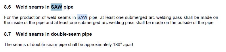

Mar 5, 2020 #1 CREERAAM Mechanical Joined Feb 23, 2015 Messages 109 Location IN Hai, DSAW pipes mentioned in the API 5L standard is that two longitudinal weld seam must be at 180 deg? REGARDS, G.SRIRAM. Dream,Dream,Dream Dream transforms in to thoughts.And thoughts result in action
Mar 5, 2020 #2 DVWE Petroleum Joined Apr 5, 2007 Messages 2,364 Location US Yes, see 8.7 of the specification. The devil is in the details; she also wears prada. Upvote 0 Downvote
Mar 5, 2020 #3 DVWE Petroleum Joined Apr 5, 2007 Messages 2,364 Location US However, don't confuse DSAW with double-seamed pipe. DSAW is welded from the inside and outside of the pipe. Double seamed pipe is two longitudinal welds, 180 deg apart. The devil is in the details; she also wears prada. Upvote 0 Downvote
Mar 10, 2020 Thread starter #4 CREERAAM Mechanical Joined Feb 23, 2015 Messages 109 Location IN DVWE Thanks for the information. So the DSAW pipe is meaning the two types LSAW PIPES and SSAW PIPES? REGARDS, G.SRIRAM. Dream,Dream,Dream Dream transforms in to thoughts.And thoughts result in action Upvote 0 Downvote
Mar 10, 2020 #5 DVWE Petroleum Joined Apr 5, 2007 Messages 2,364 Location US Have a read of 8.6 of the specification. The devil is in the details; she also wears prada. Upvote 0 Downvote

Mar 18, 2020 #7 SJones Petroleum Joined Apr 22, 2001 Messages 3,942 Location GB DSAW doesn't exist in API Spec 5L. The term "double seam pipe" does. Steve Jones Corrosion Management Consultant http://www.linkedin.com/in/drstevejones All answers are personal opinions only and are in no way connected with any employer. Upvote 0 Downvote

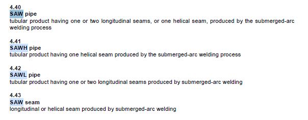

Mar 19, 2020 #8 DGrayPPD Mechanical Joined Feb 2, 2017 Messages 300 Location US "The only limits in life are those which we impose upon ourselves." Upvote 0 Downvote

Mar 30, 2020 Thread starter #11 CREERAAM Mechanical Joined Feb 23, 2015 Messages 109 Location IN SSAW Pipe some may call DSAW pipe? Thanks for all for sharing. REGARDS, G.SRIRAM. Dream,Dream,Dream Dream transforms in to thoughts.And thoughts result in action Upvote 0 Downvote
Apr 2, 2020 #12 DVWE Petroleum Joined Apr 5, 2007 Messages 2,364 Location US CREERAAM said: SSAW Pipe some may call DSAW pipe? Click to expand... Perhaps, but SAWH (Helical) some may call SSAW (Spiral). The devil is in the details; she also wears prada. Upvote 0 Downvote
