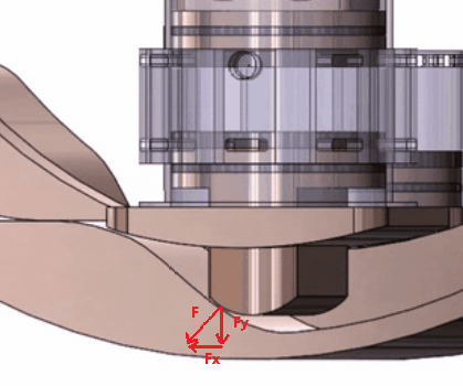

A couple questions, first, what is forcing the inner pistons to be in contact with and follow the cam? Are there bias/return springs somewhere that aren't shown?
Second, in the below screen grab of your animation it looks like the interface angle between the piston and the cam face on the power stroke is around 45 degrees, meaning that the force rotating the pistons relative to the cam (Fx in the picture) is only about 70% of F neglecting losses to friction. This would seem to hurt your efficiency and create a lot of wear as the piston tries to dig into the cam, how was this angle chosen?

The maximum pressure angle of the cam you've chosen to illustrate is actually 38.01 degrees (the max pressure angle of the inner cam is 22.12 degrees, and that of the charge pump is 41.82 degrees). Similar to a crankshaft, only a portion of the vertical force applied to the cam is transferred to rotational force. The rest remains unexpended in the combustion gas as potential work (this is why crankshafts are more efficient than some assume based purely on angles). The cam and follower are designed to handle the full maximum force applied at a zero degree pressure angle (unexpected premature detonation) with 100% margin, so there's little or no risk of plastic deformation. Because of the radius of the cam, the surface speeds are high (1509 fpm min, 7927 fpm max), and they combine with the surface width, hardness (aged Maraging 350 steel with 56 Rc), and micro-polished finish to keep the assembly in the hydrodynamic regime at all times. Note, by the way, that there's a 0.039 in fillet on the follower edges that's not shown (I accidentally left them suppressed when I ran the animation).
As for how the contact angles were chosen, I knew I wanted them as large as possible during expansion (not because they're more mechanically efficient but because they reduce the time available for heat transfer and ring blow-by) but also have to keep an eye on acceleration, jerk, and yield margin. I thus created a math model in Excel that calculates total force (acceleration, centrifugal, gas) and yield margin then increased the pressure angle to the maximum possible within the limits dictated by the need to accelerate/decelerate smoothly with minimum jerk while staying withing the stress limits.
The cams are both the boon and the ban of my design. On the plus side, they allow precise control of timing and thus facilitate HCCI. On the down side, they are finicky compared to crankshafts. More time has gone into the cams than any other aspect of the design (with fuel injectors coming in second), and I have a lot of experiments and measurements planned during the prototyping phase. If I succeed, it will be because of the cams. If I fail, it will be because of the cams.

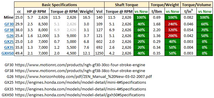

I think you're questioning power density. Below is snapshot of the comparison of my engine to several competing engines. My engine is summarized at top. The GF30, GF38, and G26 are popular engines used in giant-scale model aircraft. The GX25, GX35, and GXH50 are Honda utility engines. I use torque as the basis for comparison reflecting application driving constant speed propellers. Since most competing engines run at high RPM compared to mine, I grant them use of a lossless reduction gear and calculate their torque at 2,626 RPM. Looking at torque alone, the closest competitor has only 60% of my torque. Comparing torque/weight, the model aircraft engines kick my tail but the Honda utility engines aren't even close (note I expect to bring the weight of my engine down substantially by removing unnecessary metal, but I won't put any significant effort into that task until everything is working). Comparing torque/volume, mine wins (this is the basis for my belief mine can be made significantly lighter).

Neither torque nor BMEP is a good basis for comparing different engine types targeting the same application unless they happen to have the same output rpm at their respective design points.

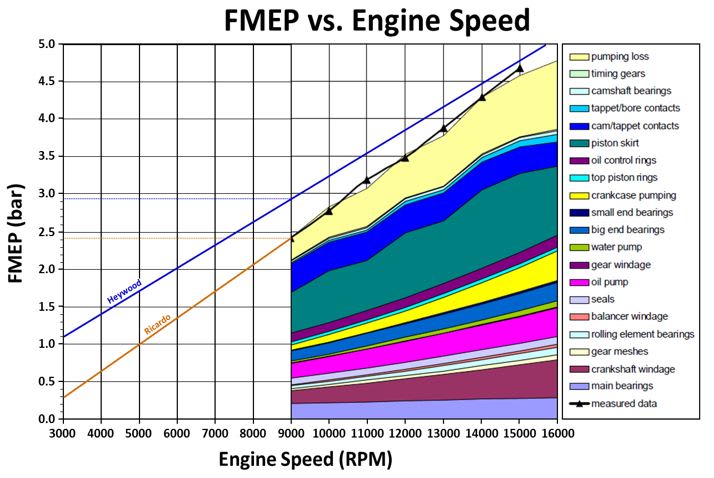

You can't use FMEP from a conventional reciprocating engine as an estimate for your FMEP. Nor can you use the [conventional engine's] valvetrain contribution to relative or absolute friction, since the power being dissipated in the valvetrain is but a fraction of the shaft power. You could use the average torque required by a reciprocating engine's valvetrain divided by a summation of the average normal force on the cam lobes as an indicator for the friction torque of your cam system per unit of the summed average normal force. How good of an indicator probably depends on many factors, but it's a starting point.
hemi said:
Neither torque nor BMEP is not a good basis for comparing different engine types targeting the same application unless they happen to have the same output rpm at their respective design points
I agree it would be unfair to compare engines designed to operate at different RPMs without gearing them to the application. That's why I granted each engine a "free" (zero size and weight, 100% efficient) transmission to multiply their peak torque (the greater of their stated torque@RPM or their HP*5252/@RPM) and reduce their shaft speed to the common RPM of 2,626.
I disagree. It's a reasonable approximation useful until motoring FMEP can be better approximated on a dyno.
I don't use the valvetrain number in isolation. I use the average of the full FMEP described by Heywood's and Ricardo's trendlines of full-engine FMEP over RPM. Of course it's not exact, but the similarity between Heywood's and Ricardo's results indicates there is reasonable correlation of FMEP and RPM. On the plus side, I used the entire estimate including all the components and subsystems that aren't present in my engine.
The fact is, I won't know IMEP, BMEP, FMEP, torque, HP, or efficiency until I test the full engine. My math models only provide approximations to guide design decisions, and I see no alternative to use of informed approximations at this phase in the process. I do plan critical experiments specifically targeting FMEP using a motoring dyno. Even those measurements will be approximations, they'll just be better approximations. The only real measures of performance will be torque, RPM, fuel consumption, and emissions of a full engine running under load.
Ok, I follow your method now, but it is obscure and needlessly complicated. Engines for the same or similar applications are normally compared via either BMEP or power density (displacement or mass basis). Comparing engines intended for dissimilar applications usually doesn't get you very far due to all the dissimilarities. By dissimilar I also mean physical size of the target application (e.g. toy model airplane vs large scale drone).
