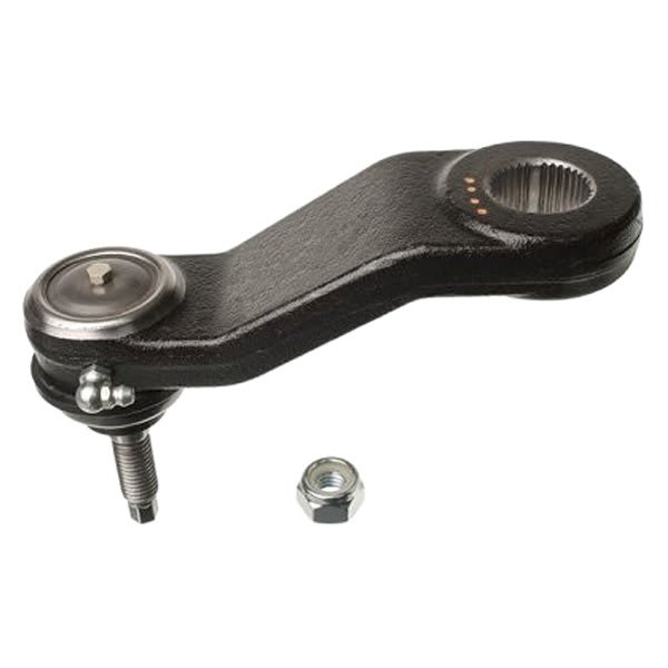

Hello,
I'm trying to figure out if there is a name for the revoulte joint integrated in a typical pitman arm that connects to a center link.
It looks like a ball joint, but it actually doesn't allow missaligment.
Are those joints sold seperatley from the pitman arm?
Thanks,
Ben
I meant the other side, like here:
Thanks,
Ben
My experience is you buy the whole idler arm.
Bob
FWIW in the previous millenium it was not completely unheard of for the pitman arm to have a tapered hole at that end, and an isolastic bushing with shaft and tapered end to be pressed into the idler arm. I seem to recall having to replace that bushing way more than the idler arm on my poor abused Corvairs.
