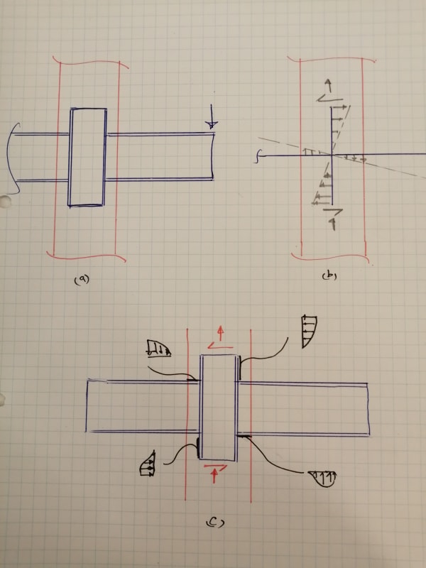

I think there is more that need to be considered here than embedded depth and no. Of studs.
Obviously, the worst case scenario will be when only one cantilever is loaded.
Considering the local behaviour, the most critical case will be for the rigid rotation of the steel beam-column, as shown in fig b. This rotation will produce stresses in the sorrounding concrete as shown in fig c. You must make sure your column is also designed for these local stresses.
You can search the web for the design of embedded column in foundation for bending moment. Behaviour will be somewhat similar.
Also, if span and loads permit, why don't you design a connection for a continuous beam passing through the Rcc column instead. Analyis, in this case, will be less complex than for your proposed detail.

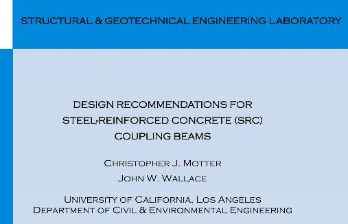

4) As for design recommendations, I would be inclined to look at steel coupling beams in concrete shear wall assemblies. Lots of research effort has gone into that area recently and you'll find no shortage of applicable design guidance. The snippet below is taken from one such design guide.

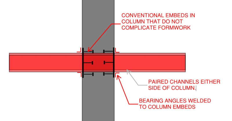

5) If it were me, and field welding was acceptable, I'd do something like I've shown in the first sketch below. It's simple, it does't mess with your column formwork, and it doesn't risk column concrete consolidation problems. Best of all, it provides a robust mechanism for moment resistance that exploits vertical force couple resistance and maximizes the distance between those forces.

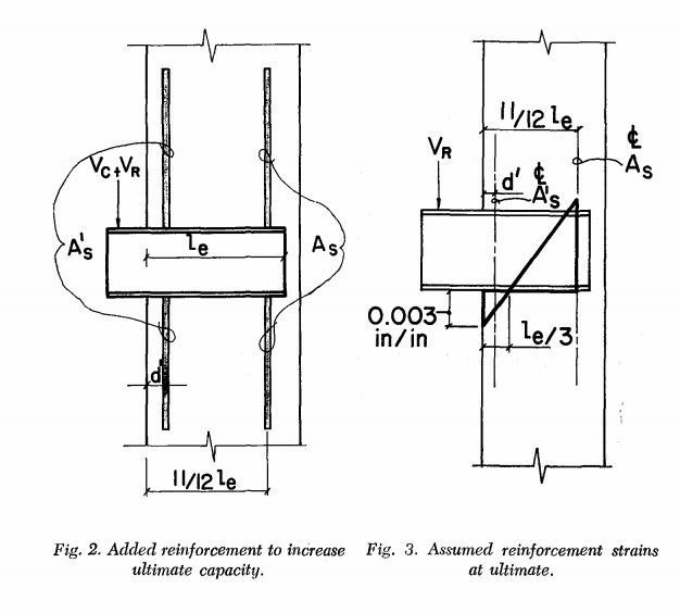

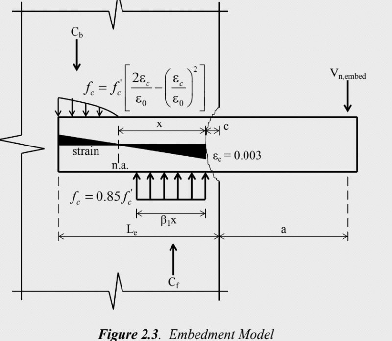

Ok. The reference I would recommend is 'Composite Construction Design For Buildings' by: Viest, et al. (1997; published by: McGraw-Hill/ASCE). Chapter 6 deals with connections (including composite to non-composite). I don't see a type quite like you have.....but they do take on a steel beam (transferring forces) passing straight through a concrete column. At another point (p. 6.86-6.89) they take on the design of a "coupling beam" (i.e. a cantilever steel beam from a reinforced concrete wall). They figure the required embedment length of this beam using methods & stress distributions similar to what Kootk shows above.

@Mahmoud: Thanks for the kind words. Happy to help. If you're going with the PCI method, this article may be of interest: Link. I believe that it was one of the source documents for that procedure.
