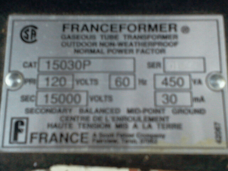

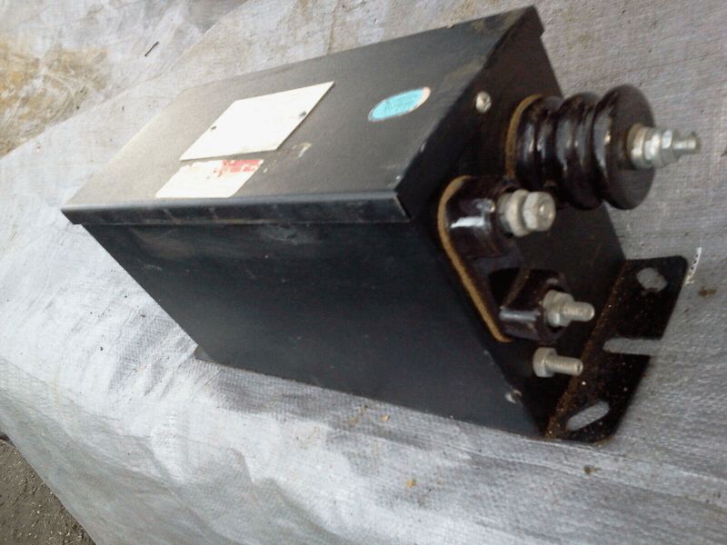

I had a Neon transformer at about 15,000 Volts.
It powered a nice Jacobs ladder.

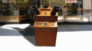

As well I had an old foot X-ray machine from a shoe store, 100,000 Volts.

Here's what the Neon transformer looked like.
This is what my other toy looked like.
