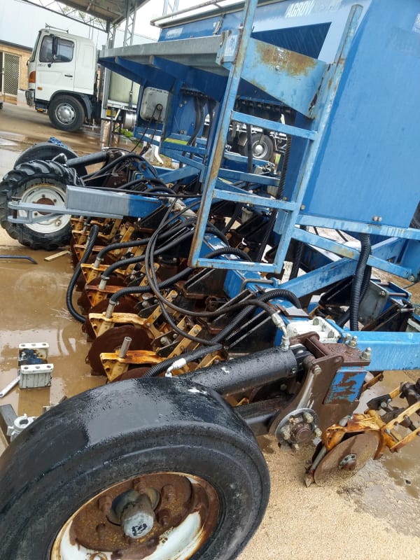

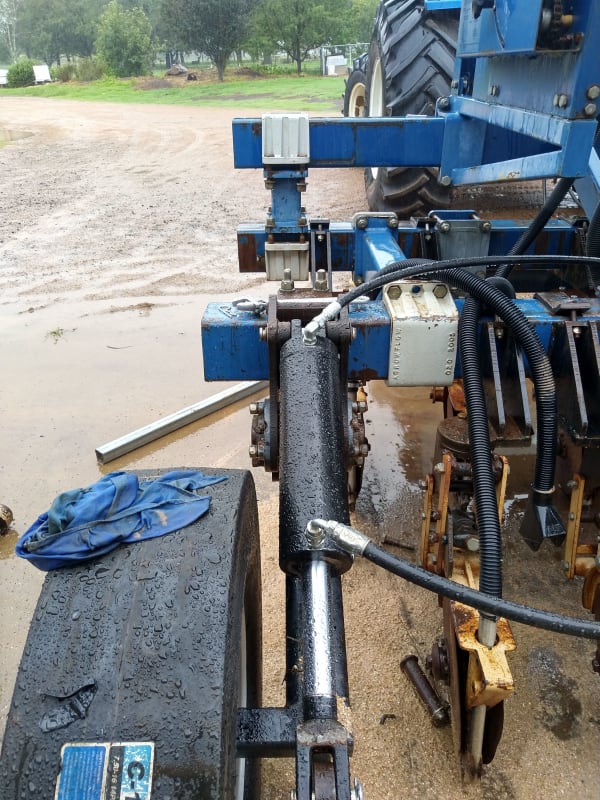

Thanks in advance. Im a old Diesel mechanic and thought I was doing a simple Job but its got me a bit stuffed at this stage.
Have a larger Ag seeder Im setting up.
Two Rams double acting of the same size.
Tractor pressure is into one of the piston ends of the Cylinder out of that same Cylinder
we have a crossover hose to the shaft end of the second cylinder then out of the piston end back to the Tractor.
Im buggered If I can get it to lift equal .
I feel Like a idiot as I worked with a lot of Hydraulics but Im stuffing this up can someone please help?
I think Im missing something simple but maybe just lost my mind.
Thanks Andrew

Please tell us more, that means drawings or pictures, about your application.

Great pictures

What is the approximate weight on each tire?

Sorry Akkamaan I missed your question about weight ,total machine weight is around 2000 kg (4,400 lb) when full of fertilizer and seed.
running new 4" bore rams with 1,3/4" rods.

The weight is not seen by the cylinders, there is considerable mechanical leverage being applied by the linkage.
