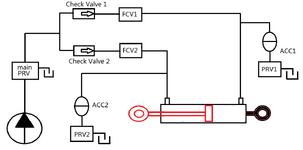

in addition, I don't have any hydraulic diagram of the system also.
I think I have to create the system from scratch. so I have this diagram, but still in doubt about the hydraulic cylinder configuration. not sure if the spring in the cylinder is still necessary. Any idea would be appreciated. Untitled.png

I checked again my diagram, and missing something, so here is the updated one:
again I explain, only one side is loaded at a time. the hydraulic cylinder is purely to receive the external impact (one side at a time), no directional control is needed.

It still isn't a damper, just a hydraulic spring. No flow moves through the flow control valves as part of the motion of the assembly. If the pressure relief valves open, then there is nothing to make up for the lost oil so the cylinder will cavitate. If flow is constantly available then the accumulators will fill to capacity and be rigid - unable to accept more oil.
Since there is pressure on both sides the rod will end up trying to fully extend and, if the forces balance there will be no load required to cause the piston to move as whatever load increase there is on one side, there will be a matching decrease in pre-load on the other.
Picture anchoring both ends of a slinky a few feet apart and then grabbing the middle and expecting it to be rigid.
At the least, the check valves need to be in parallel to the flow control valves, allowing free-flow in one side and restricted flow out the other, depending on direction. Then there is no need for the individual accumulators, just one on the pump side to ensure adequate flow during transients.
3DDave is right about the spring effect.
A damper needs something that turns kinetic energy into heat like an orifice. I have seen shocks made for tanks and other heavy vehicles. They have an orifice that restricts flow. The energy needs to go somewhere. In this case it will be heat unless fancy electrical controls are used. Accumulators store energy.
