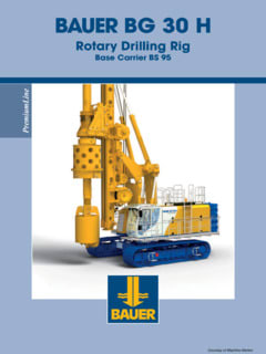

What parts fail the most on pile drilling rigs? (Ex. Soilmec, Bauer BG30...)
What parts are the most difficult to repair with local resources (ie without ordering a complete new part)
I assume in third countries diesel and hydraulics problems are easily repaired.
What about tracks?
Are kelly bar vulnerable to wear and tear?
etc.
