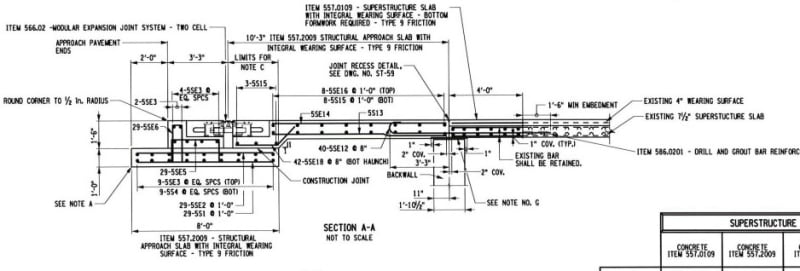

If the powers that be are all for a modular joint, why not put it in the approach slab? This way no leakage to worry about. In NY, the trend is to go jointless wherever possible.
I've inspected a fair amount of bridges with fingers, rarely have I found a problem with the assembly. It's everything around it that goes bad from lack of maintenance.
I've already made my pitch for a semi-integral abutment, bridgebuster, but was unsuccessful. They want a traditional sill type because of the large thermal movement required. I did a 485' one with the semi-integral abutment last year. We inserted a layer of elasticized geofoam (Terraflex) behind the abutments to accommodate the thermal and potential seismic movements.
Putting the expansion joint at the end of the approach slab, as in the detail you posted on a sleeper slab has become our preferred configuration for our medium to large bridges (150' to 500'). For short bridges, we typically use compression seals between the fully integral abutments and the approach slabs.
I'm curious as to what type of bearing supports the end of the superstructure in the detail you've shown. Is it a slab bridge on a stub abutment, or is that the concrete end diaphragm I'm seeing there, with a bearing below, that's not shown?
Rod - most likely elastomeric bearing with a masonry and sole plates. I’ll check when I get home.
They are elastomeric.
