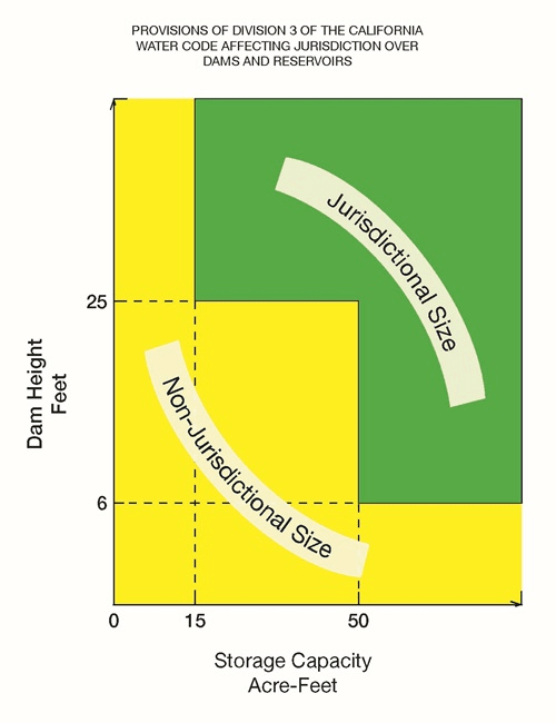

Our goal is to reduce the storage capacity below 50 ac-ft to remove the classification and requirements related to being an official "dam". The impoundment will still be used to detain water, but the storage capacity will be significantly less.
This is an arbitrary criteria, you want to get this from the regulator that they will accept this as official declassification.
Ontario Canada definition from the government
Dam: For the purpose of the administration of the LRIA, a dam is defined as a structure that is constructed which holds back water in a river, lake, pond, or stream to raise the water level, create a reservoir to control flooding or divert the flow of water.
With the above definition a drainage swale in my backyard is a dam. This type of regulation also prohibits anything being truly declassified from dam status, which is the governments right as they do not wish to have any liability even if the closed out condition exceeds the adjacent natural lands risk of failure.
I believe 49 of 50 states in the US use the 50 acre / 6 feet rule to define state regulated dams. Alabama is the sole holdout and does not have a State Dam Safety Program. there are numerous smaller, unregulated dams that do not meet the 50/6 requirement
In Colorado a non-jurisdictional dam is one that retains 100 acre-ft or less, is 20 surface acres or less and has a jurisdictional height of 10 feet or less.
