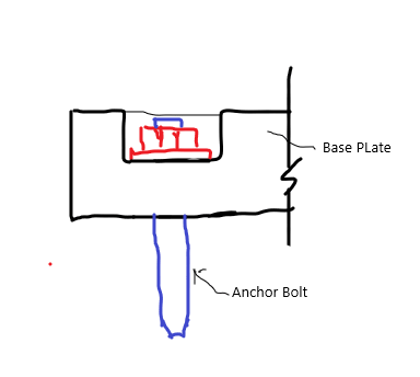

I provided a normal HSS102x102x6.4 lightly loaded column (axial 50kN, shear 2kN) with a 20 thk base plate and 4-20Ø A325 anchor bolts with Hilti HIT HY200 on a project where the base building is existing. Now the architect has come back to tell me that he cannot accept the base plate and bolts/nuts exposed above the concrete surface. I am proposing as per the attached sketch. My questions are,
1. Is it acceptable to remove nuts and plug weld the hole 10mm (half the plate thickness)?
2. What type of bolts will be weldable? ( I have seen F1554 grade 36 as weldable.)
3. To what extent the welding (heat) affect the Hilti connection to concrete?
4. Would mechanical fasteners be better solution than chemical ones?

I'm not excited about the plug welds. May work, and I can't point to a specific reason why not to do it, just doesn't feel right.
F1554 Gr. 36 are only weldable if they have a dual cert as A36 (or some other steel spec with acceptable weld chemistry). F1554 alone does not provide the right chemistry. You can go up to F1554 Grade 55 and require the weldable supplement certification (I think it's S2), and that will give you a chemistry that can be welded.
I think the more important concern is following the installation directions for the hilti product. You'll have zero visibility to verify proper filling the hole, etc. Any chance some sort of architectural cover could be placed over the base plate? See the pictures here for an example: [URL unfurl="true"]http://www.colorcraftsigns.com/Pylon-Base-Plate-Covers-Pylon-Signs_Colorcraft-Signs.htm[/url]
If that's not an option, I'd say cut the current plate off, have the fabricator make a new one with the anchors welded to the bottom, set it in epoxy (maybe leave an inch standoff to get some visibility below for the epoxy to be grouted later) and then field weld your column to it in place. Probably easier that swinging the whole column up and making the four anchors land in the holes.
Since load is light, I think you can consider provide a footing of its own, but then you need to open up the slab and do some digging.

I have done what phamENG is suggesting, with setting in the base plate (with welded anchors) into the 4 pre-drilled holes. I had a concrete filled stainless steel bollard that got hit and we had to re-connect.
But you cannot use a paste epoxy (like Hilti HY200 or SST etc) because installation of anchor rods into paste epoxy requires a twisting-action of each rod to get coverage to the all the threads and eliminate air pockets. With 4 rods (studs) pre-welded to a base plate you only have the option of installing vertically downwards, whilst keeping it in alignment and level etc. I therefore used a liquid epoxy (like Dayton superior PROPOXY 100).
1. fabricate your base plate with pre-welded rods to u/s plate;
2. drill 4 x holes to concrete;
3. clean holes with wire brush and oil-free compressed air;
4. repeat step 3 - cause your hole can never be too clean :)
5. dry-run install the base plate/rd assembly for fit - adjust (bend) rods to suit;
6. mix epoxy and grout 4 x holes to 2/3 of hole depth;
7. insert base plate/rod assembly and align/level with wedges.
8. field weld column to base plate.​
I have used a hydraulic cement 'dam' around the perimeter of the base plate, so when the base plate/rod assembly is installed it 'floods' the area with epoxy and is contained so you get a bit of resin under the base plate and then when it cures simply chip the hardened excess resin from the plate perimeter.
Bit of a tedious and messy process - hopefully you do not have too many on these to do.

I must agree that I did not think of welding bolts under the plate and then Hilti them in as suggested by @Ingenuity and @phamEng. I will go with this suggestion. @retired13 This is a suspended slab and not SoG.
