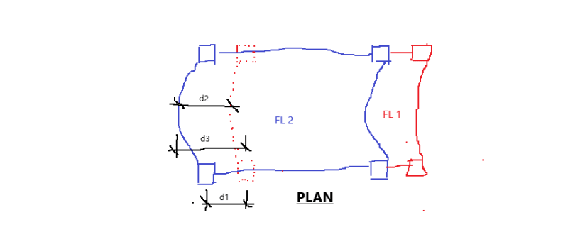

ARKeng,
Which one below (d1, d2, d3) is each group pointing to?
retired13:
Just to be clear I am correctly understanding the graphic. Here's my understanding of your three dimensions:
d1 = how far the columns move story-to-story (column here could be shearwall deflection also). The technical term I would have previously used to describe this would probably be the "drift of the vertical elements" (similar to the ΔADVE" for the "average drift of vertical element" term from ASCE 7.
d2 = the maximum movement of a point on FL2 relative to the same vertically aligned point on FL1. This is also what
rscassar seems to be showing above. I previously would have called this "story drift"... further discussion below.
d3 = the total absolute horizontal displacement of the worst point on FL2.
Until this past week, I would unflinchingly have said the story drift we are interested in with respect to code limits is depicted by "d2". To me, it was basically finding the "d3" of every point on FL2 and FL1, calculating a d3(FL2) - d3(FL1) for every location in plan view, and the worst case of any of these values is "d2" and I would have called this story drift. At the bottom story, d3 and d2 are the same thing.
Now, I seem to be interpreting from the SEAOC source that the code limit only applies to "d1".
This is odd to me because in terms of the worst case of what the gravity columns and non-structural elements experience, they see "d2" so that seems to me to be what the code would want to limit.
I would also say the SEAOC process seems convoluted. ASCE 7 gives only the vague requirement of 12.12.2 that limits the diaphragm deflection. SEAOC then basically says to use 12.8.7 to limit the P-Δ, but to essentially use your "d2" instead of using the story drift... If this is that the case, why not just use "d2" from the beginning as the defining limit?

Thanks to everyone for weighing in...I believe a good summary of the consensus is that:
1. Diaphragm deflection components are not included in story drift limits
2. Diaphragm deflections obviously have to be considered in issues regarding property line, building separation, etc.
3. The main code-limitation on diaphragm deflection from a structural strength perspective is the stability affects on other elements.
