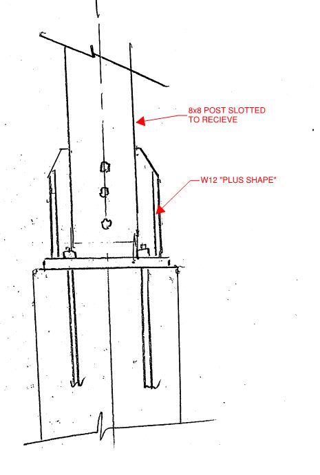

Why not take this a step further and have a vertical "Plus" Shape to avoid the weak axis bending.

Quote (dauwerda)
Love it. But then the question become what is that "plus" shape, how does it look, and how does it allow the connection to be drawn in for shrinkage. Obviously, Ed's got on answer to that. What have you got in mind?
RE: Wood light pole base
No doubt I am completely fooling myself in thinking that anyone might find this sufficiently attractive.
The problem with tightening bolts in the cruciform configuration would be similar to that of the I that Ed suggested when you look at the bolts going through the "web" of the I. If we assume 6% average shrinkage perpendicular to the grain (radial and tangential) over a 30% moisture swing, and further assume that we're going from 19% as delivered lumber to a 12% dry equilibrium MC in dry months, then a 3.5" block would shrink about 0.05" (figure a 1/4" steel plate and you have 4 3.5" blocks with .25" gap). So we end up with a total of about 0.1" of slop in the joint. Half of that is taken up by the bolts being snugged up to the surface of the wood, the other 0.05" by bending the wood to contact the steel plate. Might be a problem if your connections only an inch long, but if you run your cruciform up, say 8" into the wood, then you're looking at rotation in the wood of about 0.36o. Probably not enough to be worried about.

Ah... plus = cruciform. Now I get it. I don't love it though. I think that the post would be too chewed up at the bottom by the time that you got all that slotted in.
Not if it's done right. Assuming 1/4" plate works, you essentially have four 4x4's within the connection.
You could also go so far as to reinforce the connection region with a) a thin steel plate or sheet screwed into the post or b)2x12's mitered around the corners and screwed into the post.

I don't buy it. By the time that you get two columns of bolts flying through that, I think that it'll be a dog's breakfast of beat up timber. And each one of those 4x4's needs to be an upside down cantilever of sorts.

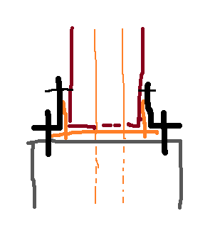

It's too bad that one can't count on a slotted hole to not bind up. Otherwise, you might slot the anchor bolt holes and provide connection angles that move with the wood shrinkage.
I can never seem to resist trying for a better mousetrap with this connection typology but I really should know better by now. We've probably been through this here half a dozen times since I've been paying attention and we never seem to arrive at a fully awesome connection other than the Simpson gadget.
Super fancy eruo-timber connections aside, I've come to the conclusion that wood just isn't meant to base cantilever unless it's via a root network.
