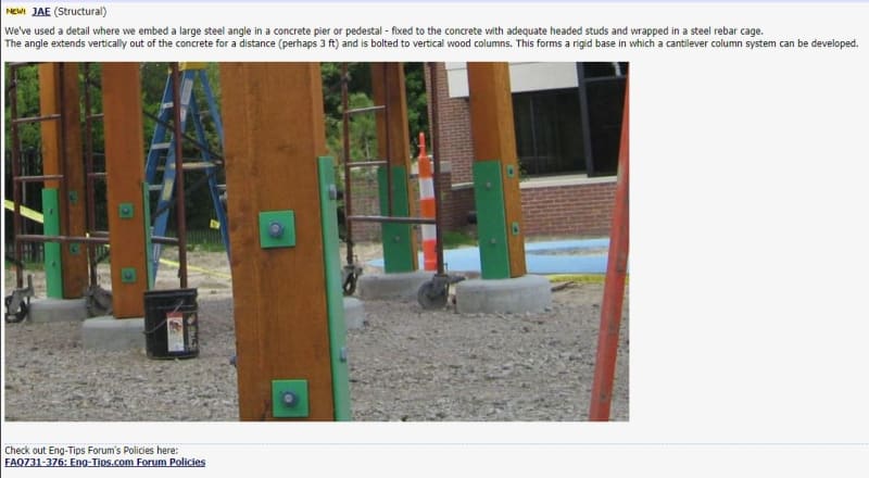

I have a blast from the past. JAE did some wood moment bases several years ago. I saved the picture he posted, but I do not remember the name of the thread.
He had multiple posts, so was able to create a system of moment resisting columns. Unfortunately, you just have 1 post.
There might be other good info in the thread though. Or JAE might see this post and remember.

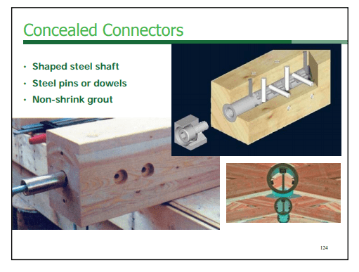

Check out this presentation from the American Wood Council, particularly slide 124, may be of interest.
