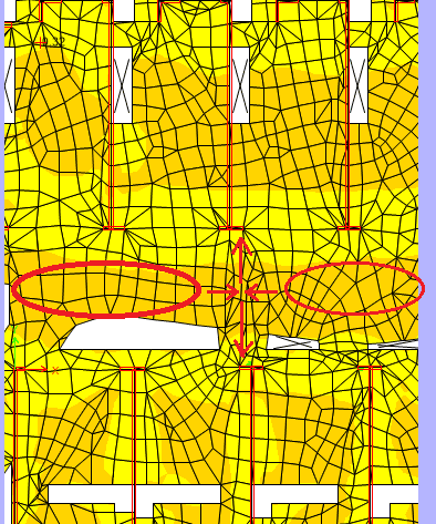

It is my first time to design irregular 2 way slab and I need some help from you.
I have used FEA for the slab analysis and below is the shell stress. Most of the stress is less than 3 MPa. but I have noticed that the stress in some mesh is greater than 35MPa (the green ones). Why is that? Is it more because of the model error? (There is only UDL on the slab. no point load added)

Have to echo what BA said about those openings.....the word constructability comes to mind. Not that it can't be done.....but would be quite a challenge.
In any case, to answer your question.....what you are referring to is most likely a stress concentration. They occur because of geometry, supports, etc. Assuming those red lines are walls, it most likely is because of that.
For the 2 way reinforced concrete slabs I have done in the past, I typically have based my design on moments and shear stresses from the analysis. You can justify the force "spreading out" (i.e. smoothed) based on how wide spread it is and the geometry of the situation.
Agree with WARose likely seeing stress concentrations.
With the irregularity of the slab layout and openings I'd also say the mesh you have shown is too coarse and needs some refinement. Be careful with those stair openings in the middle of the units, especially the L shaped ones, FEM may say the slab is OK but for serviceability considerations these likely want to be framed out with beams.

In my opinion, you shall try refine your model, so the majority of elements will conform to orthogonal grid system (xy, or xz plan), and only use triangular and irregular elements at locations that couldn't avoid. Use finer meshes near rigid elements, such as column, wall, etc., and coarser element at other locations, but always maintain good aspect ratio. Otherwise, your analysis will be quite difficult to interpret, yet to be used for real design. The color will be quite impressive though.

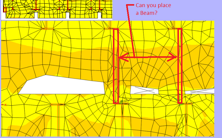

3. Are you displaying the Von Mises stress for the slab? In looking at your model, I'm not surprised that you are getting such high stresses at that location. It looks like the slab in that location is acting like a strong band. There is a lot of load that is being resolved at that point. Can you put a beam between the walls? See attached.
The stress, however, is probably not accurate since your mesh is not refined enough at that location to capture the true stress concentration.
4. This is a perfect example why many Engineers opt not to use FEA to solve a problem like this and rather try and simplify it with more basic equations. i.e. strong and weak bands. FEA is nice to see where the highest stress concentrations are but it doesn't really make the design and detailing any easier. This is a good lesson though. Is this a PT slab? Flat plate?

These irregular shapes are as per architects' dwgs. Unfortunately I can't place beams like what STrctPono suggested as you can see the walls above and below don't always line up and some voids are just located in between walls, which make it impossible to place beams linking walls above and below.

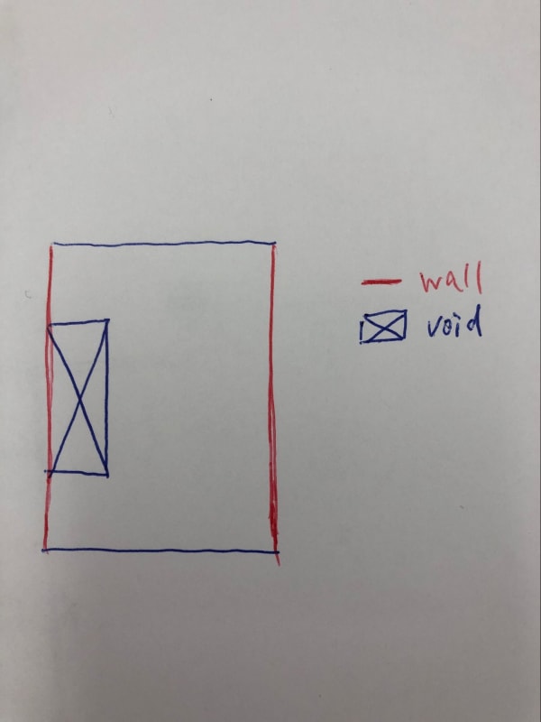

I also have a simplified question regarding this, how do you analysis the following simplified slab?
What software are you using to design this slab? I would never use a general FEA package for concrete slab design. You need specialist software such as RAM Concept that is able to make allowance for Mxy stresses, check punching shear and (most importantly) calculate long-term deflections including creep and shrinkage effects.

It appears that your stress concentrations are occurring on poorly meshed portions of your structure. A common theme is that your mesh elements with high stress are triangular, similar to a pie slice when someone asks for "just a tiny one". Because of the narrow element and the sharp tip of that element, stress concentrations are occurring at that location. Any mesh generation instruction text will discuss this pitfall of triangular elements.
I don't mean to provide a lecture on the intricacies of FEA, as that already exists on these forums in many other threads, but I will say this: mesh generation is fundamental to the accuracy of your results. There are many good resources online, and often from your software provider, that give advice on mesh sizes and shapes. Just looking at the images provided, I am willing to bet that your mesh was automatically generated by the analysis program, and I have to say that it didn't do a spectacular job of it.
I am not sure if ETABS can import a mesh, or if you are forced to use its own mesh generation tools? If you can import a mesh, then you may want to look for a better mesh generation tool to help you get this complicated shape more accurately modeled. Otherwise, using the program's own mesh refinement tools would be adviseable to avoid these "thin pie slices".

Even if he tightens up the size of his mesh and changes his triangular to quadrilateral elements (which I agree with you all), there is still a significant amount of load being dumped from the surrounding slab into that one narrow band of slab that spans from one end of the wall to the other. Most of the other slab actually seems to be behaving like a one-way slab.
