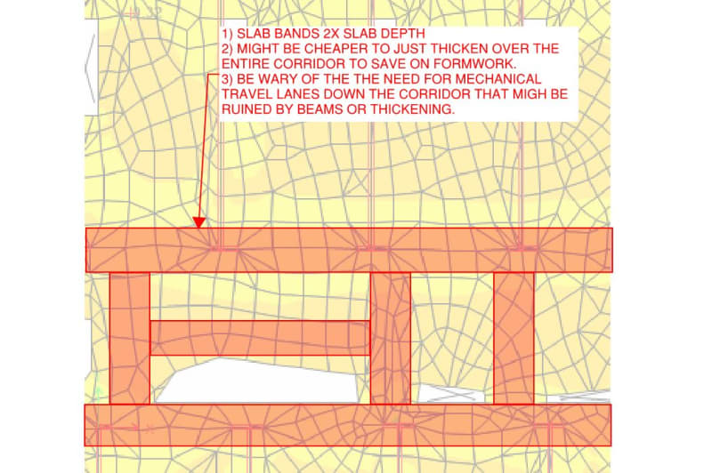

It is my first time to design irregular 2 way slab and I need some help from you.
I have used FEA for the slab analysis and below is the shell stress. Most of the stress is less than 3 MPa. but I have noticed that the stress in some mesh is greater than 35MPa (the green ones). Why is that? Is it more because of the model error? (There is only UDL on the slab. no point load added)
Also. what books do you guys recommend for slab design? I am not very confident in arranging the reinforcement correctly. Can anyone provide some resource for irregular slab design example including the reo arrangement after analysis? Thank you very much.

I also have a simplified question regarding this, how do you analysis the following simplified slab?
You can design this slab in many ways. By visual measuring, the aspect ratio (short/long) is less than 1:4, so first design it as two way slab without the opening. Once the bar size and spacing are determined, bundle the bars, that are to be placed in the opening in the long direction, to the long edge of the opening to create an embedded beam strip. You may then want to add a few bars along the short edges of the opening to stiffen the edges. The last thing is I would add diagonal bars at the corners to minimize crack length and width.

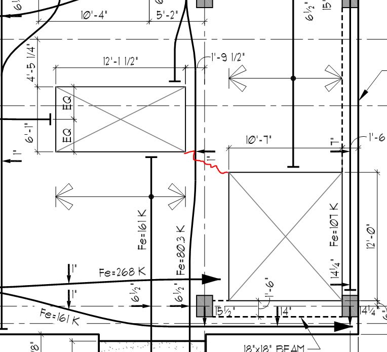

2) I have found it frustratingly difficult to find a decent reference on practical, modern slab design using modern tools. The classical strip methods that you find in most university textbooks are useless to me other than for providing the historical context for how rebar detailing typically needs to be handled. The one decent reference that I now of is shown in the first clip below. Besides that, I've found that books on post-tensioned slab design tend to be better at covering suspended flat-work than generic concrete texts. One good example is shown in the second clip below.

You do gotta be a little careful those big openings though. The richy-rich penthouse of my first PT building had all kinds of massive two story openings up to the loft. I designed the snot out of everything so that the balancing forces had the slab weightless! Then the contractor went and stacked a zillion pounds of cold formed studs on one of my stupid bridge things, using it as a staging area. You know, because I didn't explicitly say that he couldn't do that. It opened up a crack in the bottom big enough for me to count the strands passing through. Pretty great.
There might be another way to make a beam-ish solution work if, in fact, you have head room available for that.
