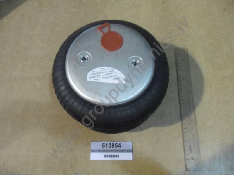

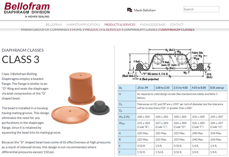

there are two common type that we use. first is a fabric type (first photo), second is rubber bellow (the one that is normally used on a truck as suspension unit).
R.Efendy
Thanks, BEMPE, that is good to know. I have used the Bellofram rolling diaphragm air cylinders where piston friction is a problem. They are a very good product.
