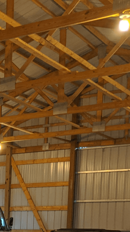

Hi all, engineer from another realm stopping in. I have a BSEE and Masters of Engineering in Materials Science, but neither of those qualify me to do structural engineering so I'm seeking some quick advice.
I'm looking to decorate the exposed 40' trusses in my shop, the thought being:
-attach dimensional lumber to the sides of the trusses to just make them appear to be the same thickness as the 6x6 poles.
-cut the slop off the 2x4 lateral braces, and maybe thicken them for visual balance
-add extra knee braces for symmetry
-stain all the wood dark brown
I've read that decorating trusses "usually doesn't require engineer involvement", and I'm removing nothing, only adding. But better safe than sorry, so I'm here to see if this gets a reaction of "nah you're just adding decoration that, if anything, is extra bracing so nailgun away" or if it's more like "hire a structural engineer or your trusses will collapse under their own weight"

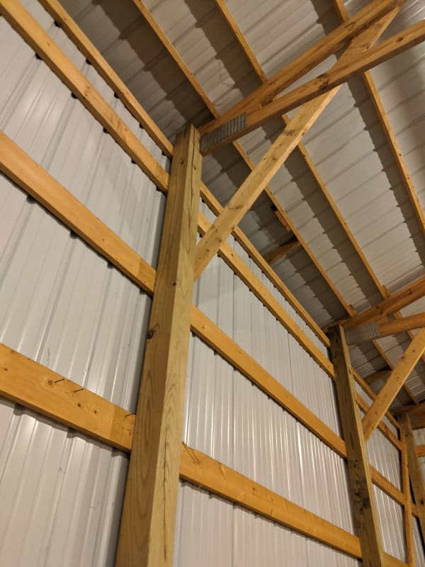

A couple photos of what I'm working with.
1) Correct answer = "hire a structural engineer or your trusses will collapse under their own weight".
2) If this was my shop, I'd do this without batting an eye.
3) Braces look like they could use a little beefing anyhow. Let us know if you'd like to do that strategically. It's not unheard of for the columns to be cantilevers such that the braces aren't required though so I wouldn't panic.
Is there such a thing as snow where you live? The greater the snow, the less the impact of your plan.

I'd not do it. The reason is you are then hiding important parts of the trusses that carry loading. Then, down the road there is some accident or fire, etc. Your claim for damages likely would be of no value since you modified he trusses somehow. I'd also check with the insurance company now. They may invalidate any coverage right now.
As far as attaching extra 2x's to the side of the trusses, it will add a small amount of extra weight. Your profile says you're in NY, so I'll assume the snow load is fairly substantial. If that's the case, the extra weight should be negligible. If you offset the joints in your added pieces on each side of the truss (start with a full 12' piece on one side and a 6' piece on the opposite side of the truss, and continue with 12' pieces), it will make the trusses a little stronger.
As far as the lateral braces, not all extra is 'slop'. There needs to be enough extending past the attachment point so that the end doesn't split and release the nails or screws. It's been a long time since timber design class for me, so I'm not sure how much you may need to leave.
Adding the extra knee braces may stiffen the connection in ways that could cause some prying. I don't know if that's likely, or if there's a way to mitigate the effects. Hopefully, someone with more experience in this area will weigh in.
I don't know of any detrimental effects from staining it.
Leave the wood work alone, don't do anything, but stain all wood to dark brown. It will be looks great then.

I don't know exactly what the story with my knee braces is, every other barn of nearly identical construction in my area doesn't have them, I had one old house builder tell me if it was him he'd just remove them so they aren't in the way (I added that to the scary bad advice pile)
In any case, I was planning on just thickening the trusses and copying the braces on the other side, what would be a more strategic way?

Part of me wonders whether it may be possible to buy new trusses, with center-span field splices, and throw them up there for cheaper than hanging around on a rolling scaffold, scabbing 2x's on the trusses? Heck, then you get some added skookum factor as well. Just a thought...
I'd be careful about adding knee braces. These can impose funny loads into the truss. If you do, add them so that they join the truss at a "node" (layman's terminology: where the sticks hit the shiny bits).
I don't think the edge distance needs to be much (probably just a few inches), especially if it's just nails connecting it. I am hoping maybe somebody that's more familiar with this aspect will weigh in with something more definitive.

Any chance that this building had to be permitted when it was built? If so the city/county may have the truss drawings on file with the permit. Many jurisdictions that don't require full blown engineering for structures still require stamped truss drawings to be submitted with the permit application. If so, you should be able to look at the drawings to find the design criteria, many post frame trusses (not all) are designed for a 3-5psf bottom chord load to allow for ceilings, lights, etc. If the original design included this, then there really should be no issue with adding the architectural features you describe.
That said, I agree with KootK, if it were my shop I would do it without batting eye.
By looking at the construction of the building, I am fairly confident that it was built using "standard" techniques and there was no engineering done originally (other than the trusses). That said, the trusses were probably not designed to accommodate the knee braces, some builders put them in and some don't. In my experience, most engineered post frame buildings utilize the steel roof as a flexible diaphragm and the steel sidewalls as shear walls (sometimes the walls will need to have plywood/osb installed on the inside if the wall is comprised mostly of openings) and don't require any braces. Both knee braces and wall bracing in post frame construction tend to suffer at their connections, most of them are installed without adequate fastening. You can read up more on knee braces here, (I have no connection with Hansen but they are very knowledgeable in engineered post frame buildings)
Based on the testing cited in the link above, if it were my building, I would remove the knee braces unless I knew the original building was actually engineered to include them.
Is the "lateral bracing" you are referring to, the truss bottom chord and web bracing that is shown in the bottom picture? If so, yes, you should be able to cut the excess ends off. I don't believe the NDS actually specifies a minimum edge or end distance for nails with a diameter less than 1/4", however maintaining a 1" distance between the nails and the end of the board should be adequate.
