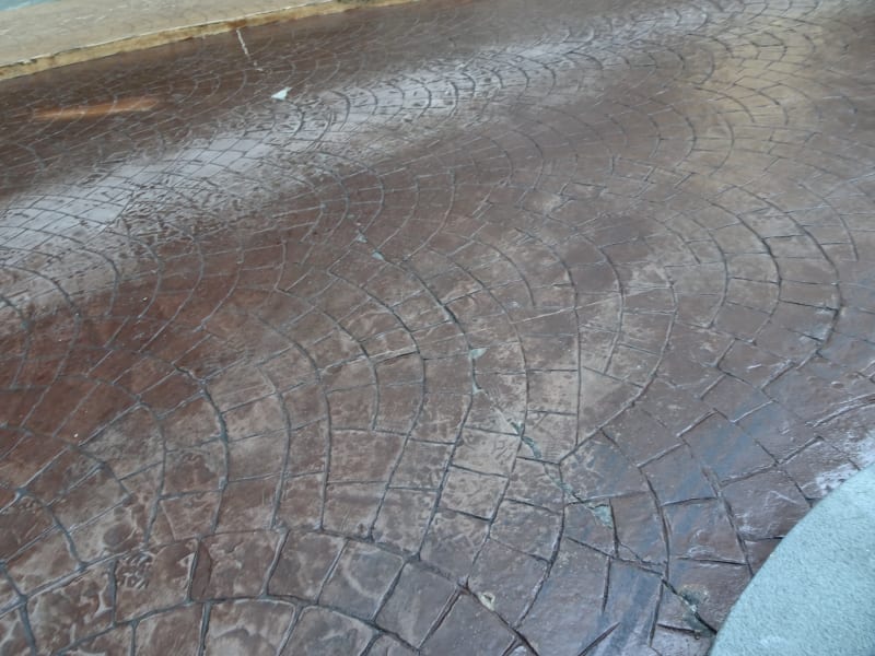

Are those pavers or stamped concrete on the ramp surface? Is there any sign of damage to the surface that would indicate an impact as BridgeSmith suggested?

i didn't see another crack from below. mean is not AAr reactions. but i get the photo of crack on the above ramp. but the crack is about 4ft away from the spalling concrete.
