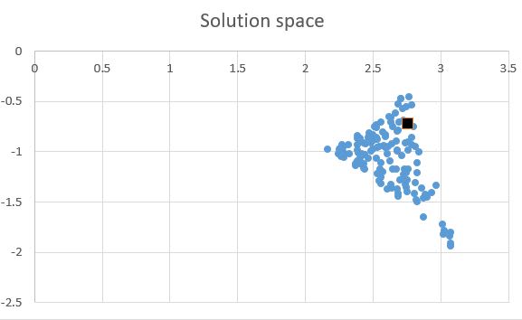

One effective method for finding simple optima is to use a Monte Carlo, that is, just random sets of inputs. Engineering judgement can then be used to find the global optimum.
here's the solution space for a 2 factor problem, the black square is a feasible solution using production parts, not quite as good as the optimum at(2.8,-.45) but not bad. This was all done in excel.
Cheers
Greg Locock
