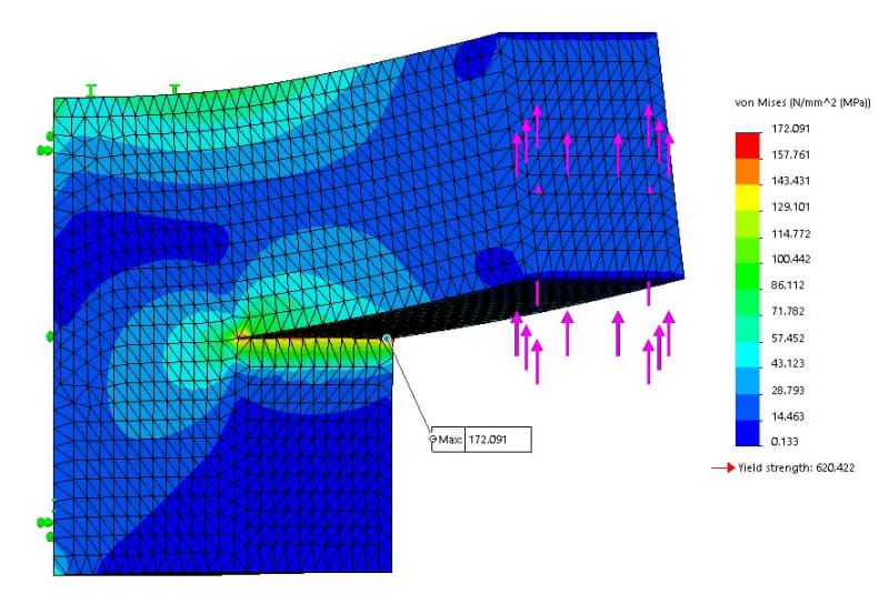

Hello Forum,
We are designing a pressure vessel as per ASME Sec VIII Div 1. For one of the part which is neither standard nor there exist design & construction requirements for such parts in this div, hence we have to use the U-2(g) to comply with this div. Please refer below image which nearly represent the part design concept. The part is purely under bending due to pressure load. As per the FEA results, the bending stresses are very low and are within the allowable tensile stress limits as given in Sec II part D except the notch portion as shown in the picture. For this notch, can we use the higher allowable stress as per UG-23(e) i.e., localized discontinuity stress as 3 times allow stress? Although it seems to be a perfect corner at notch, there will be suitable fillet rad & same is already modelled during the FEA as well.
Do share your opinion.

Hi GD_P.
It seems like the high stress you see in the notch is a consequence of singularity of this point - sharp corner.
Try to use small fillet radius in this corner.
You may find this article helpful: There are a lot of examples regarding this issue here:
In addition, I made a small example - same boundary conditions and mesh size.
Model with sharp edge, stresses go to infinity.
Model with fillet radius, stresses has converged

You are right, 2019 code edition has introduced appendix 46. This may be helpful, but honestly speaking I am a layman as far as Div 2 is concerned. Also if you see the image of concept design & loading, it very basic bending problem & there is no need to introduce the FEA. The only reason to introduce the FEA was to evaluate the notch stresses (which are known as Localized discontinuity stress IMO, correct me if I am wrong). After analysis I am using the allowable stress as per UG-23, isn't this procedure adequate as per Div 1? I am just trying to avoid the extra efforts , which may be required if we introduce Div 2, please correct me if I am wrong.

You don't need to do FEA to use Div 2. Hand calcs are often sufficient, as in your situation.
I'm pointing you in that direction to get a better understanding of the rationale behind the different "limits". You ought to understand those, regardless of whether you do FEA or not.

If you are about to design a Section VIII-1 vessel and you are going to use U-2(g) and FEA in accordance with Section VIII-2 Part 5 you have to use Mandatory Appendix 46 (App. 46, 46-4(c)(1))
For your example, just choose which kind of FEA you want (and can) to apply and then, you need to analysis your results in accordance with the relevant paragraph from App.46 and VIII-2 Part 5.
