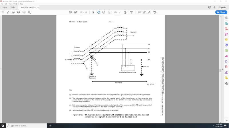

Why is grounding the neutral at the transformer and generator forbidden? I can't see any reason for this as the neutral will not be carrying load current and thus no objectionable current would be present.
I think the distribution is 3-ph, 3-wire. Neutral is not taken to the loads and probably there are no single phase loads directly connected to the switchboard. The Protective Conductor (PE) wire is taken from the switchboard with each of the outgoing feeders. In addition the PE also is earthed at individual installations to lower the earth loop impedance for single line to ground (SLG) faults.
PE as well as neutral of transformer/generator are earthed at the switchboard.
Multiple earthing of neutral (independently at the transformer and at the generator) will split the earth fault current, making it difficult to detect the fault by the protection that is energised by the CT in the neutral-to-earth connection.
Withe existing arrangement, the earth fault current magnitude is seen in the outgoing feeder and the one in the neutral CT will be same.
Correct- there are no line to neutral loads.
My understanding is that with the CTs in the phases and zero sequence being summed there, no ill effect will come from earthing the neutral at both sources.
Circulating currents through the earth are possible with multiple earthing points. This is avoided with a single earthing point. Also, SLG fault current can exceed bolted fault current when both transformer and generator are earthed, possibly destroying a generator not built to withstand more than bolted fault current.

Where would these circulating currents come from and what would cause them?
Where is the protection sensing (LV Breakers or CTs)? The multiple grounds provide paths for current through ground that should be on a conductor and should be sensed by the protection system.

When a protection scheme includes Ground Fault Current monitoring, all of the normal neutral current must return on the neutral conductor. Any shared neutral current returning on thewill be interpreted as a ground fault current and cause a trip.
Another possible issue is the effect of current passing from one grounding electrode to another grounding electrode.
There have been cases where a current passing through the ground has dried out the soil and caused the resistance to ground to rise above acceptable limits.

In addition there are often different wiring methods for a neutral conductor versus a grounding conductor.
A parallel path for the neutral current may mask a broken neutral or a failing neutral connection.
Most important:- It's the code.

But- again- its a 3 wire system, not a 4 wire.

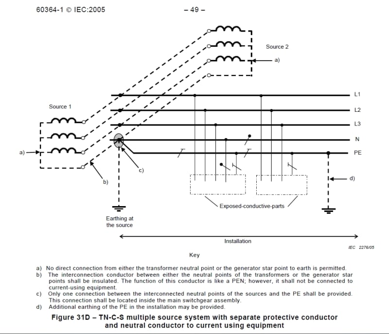

Here is the version with line to neutral loads, understandably you would want the neutral grounded only at a single point:
When I look at those diagrams I see a four wire system, not a three wire system.
Even if the neutral is not in use, it is a four wire system.
The neutral must be run from the source to the main switch-gear and grounded in the main switch-gear.
If you don't want to use the neutral you don't have to carry it beyond the main switch-gear.
It may then be considered a three wire system but it is derived from a four wire system and grounded as such.

IEC60364 certainly wants it that way- but I'm stumped as to why. It may be four wire, but the neutral is only for grounding providing an effective low impedance path to facilitate the operation of OCPDs. Grounding it at both sources as well as the gear would not present any ill effect IMO.
There seems to be confusion on whether the 4th wire is a neutral or a protective earth. In the OP Mbrooke calls the wire in the drawing a neutral but it is labelled PE.
Some of the confusion may result from the omission of the specific earthing type in the originally posted diagram.
I.e. TN-C is a combined PE-N, where the star point is both earthed at a single point and used as the Neutral, as per the first two diagrams.
The last diagram shows a TN-C-S, where PE and N are (C)ombined ahead of the single grounding point, and (S)eparate when provided to the loads.
The systems shown are all 4 wire. Both arrangements are quite common in LV Remote Power Stations here in Australia, although the TN-C-S is likely more prevalent as separate site light & power is not fed off its own transformer.
EDMS Australia
It is labelled PE, but the foot notes want you to treat the dashed PE as a PEN conductor. See foot note "b"
