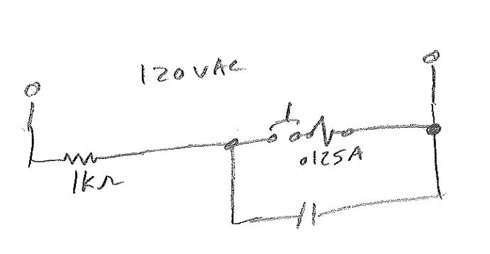

I trying to make heads or tails of a simple trip circuit. I have not seen a circuit such as this but they tell me the wiring is correct as shown in the drawing. Sorry for the crudeness of the drawing.
If the contact below the breaker closes, it trips the breaker. I am totally missing something if this is how it is actually wired. Sure the polarity reverses but at the same time, there is not potential difference across the breaker to develop a current. What is the theory of operation of this circuit? I am probably having a major brain malfunction as it has been a long couple weeks.

A shunt trip?
A small solenoid inside the breaker that mechanically trips the breaker?

That's nonsense. You're correct, something is fishy/wrong.
The drawing is entirely missing a shunt-trip that is mechanically tripping the breaker from next to it, as Bill suggests, or that's not a contact it's an idiot-light that only lights once the breaker opens and specifically it's a neon idiot-light.

Problem solved. The contact is closed when everything is ok, not opened. Obviously, this allows next to no current flow through the breaker. If there is an issue, the contact opens, diverting most of the current through the breaker causing it to trip. To top it all all off, it is totally unnecessary...the breaker has some aux contacts, which are then placed in series with a trip circuit. I am not sure why they didn't just use the contact that is shown in my drawing in the trip circuit...(if it is not an adequately rated contact, then use an aux relay). Goofiest thing I have ever seen...
Thanks all and sorry for the drawing link and the later than I like reply.
Yes it is Keith! Thanks
1000 Ohm at 120 Volts? That's 0.12 Amps.
It will take a very long time to trip a 0.125 Amp breaker.

Sorry, forget to mention it is a variable resistor and is set at something lower than 1k. This is an explosion proof box and I didn't want to remove 30 plus bolts to measure it.
