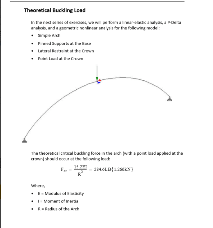

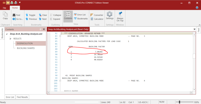

There is a ptoblem that I tried to solve with different types of analyisis Using STAAD software ,for the arched beam that I am trying to analyze the theoretical buckling load was 284 lb , using the linear elastic analysis it didnt show any failure . P delta analysis indicated failure at load much higher than 284 , non linear analysis gave the most accurate result with buckling load around 280 , but using the buckling analysis it showd me that the buckle should occur at 157.5 , I searched and understand the diffrences between the linear, p-delta and non linear analysis. My question is why the buckling analysis gave results that differs alot from the non linear analysis ? Can someone help me with that.

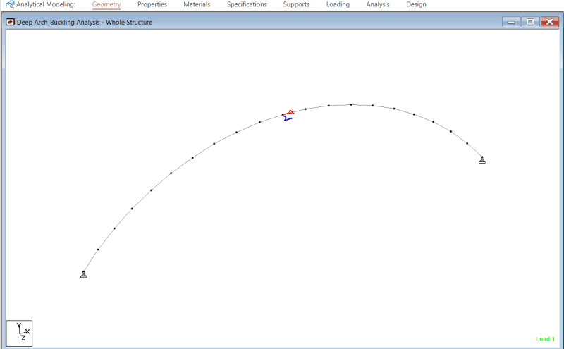

Can you share a picture of your model (showing its geometry, load and bounday conditions) ? Simple 2D scheme will be enough. Also could you provide a reference for your analytical solution (basically where you’ve found formulas for buckling of your structure) ? This would help me find the reason of such discrepancy in results.
In case of arches typical buckling mode is snap-through. Linear stress analysis won’t give you results for this case but linear buckling analysis usually gives highly inaccurate results as well. In most cases it overpredicts the buckling load (actual structure will buckle at lower load than indicated by eigenvalue buckling analysis). However in snap-through problem it may significantly underpredict the buckling load. To obtain correct solution for such problem you have to use nonlinear analysis.

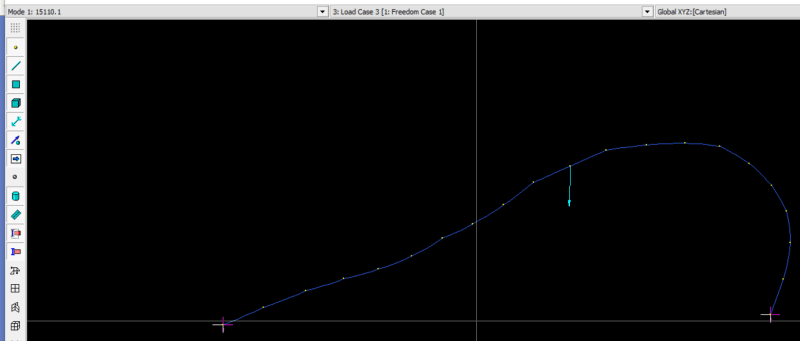

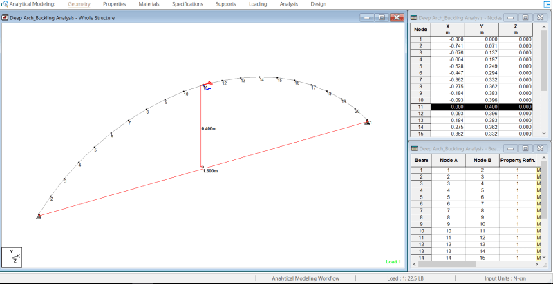

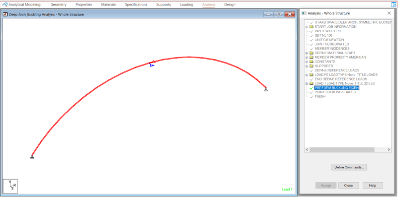

Thank you all for the answers, really appreciated. Here are some images for the arched beam that I am trying to analyze, the theoretical buckling load is as shown, equal to 284. But the staad buckling load factor was 7 for the first mode, which means that the buckle will happen at 7*22.5=157.5 lb which is much lesser than 284 lb. and this is where I lost it and can not really understand why it differs alot from the result from the nonlinear analysis .

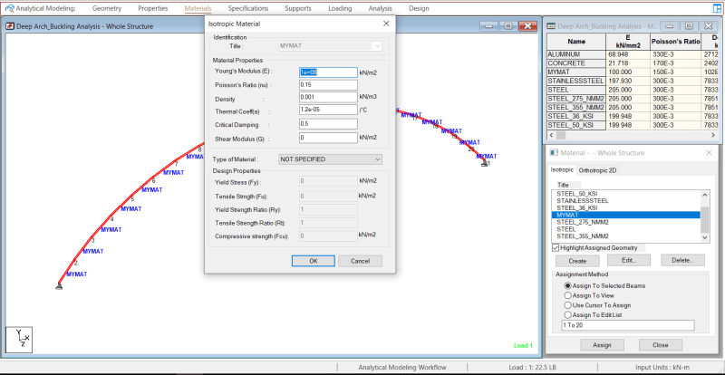

Does setting the shear modulus to a non zero value get better agreement?

Where did the 15.2 factor come from?
I couldn't find anything for buckling of an arch under point loads in Roark, Timoshenko & Gere, or Pilkey. I didn't find a definitive simple formula on-line either, but the paper below gives experimental and FEA results for an aluminium arch under central point loads, and also discusses discrepancies with earlier work. Note that the buckling mode in this case is out of plane buckling, resulting in combined bending about the weak axis and torsion.

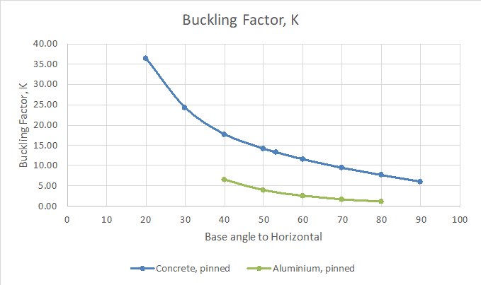

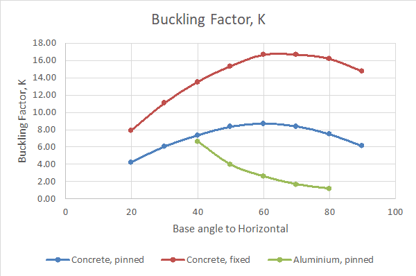

I did some 2D analyses using Strand7 and found good agreement between a linear buckling analysis and an incremental analysis with full geometric non-linearity and elastic material properties, provided a small initial imperfection was included in the non-linear model . Results are shown in the graph below:
The results labelled concrete are from my analysis with a 10 m span and 1 m wide x 0.3 m deep reinforced concrete section, with pinned or fixed end conditions. The aluminium results are from the paper linked above, which was a 500 mm span with pinned ends allowing in plane and out of plane rotation and warping at the supports.
To allow a better comparison of results could you supply:
The arch span and height and base angle.
Cross section details and material.
End conditions.
It would also be useful to check the deformed shape plot from the buckling analysis (my strand7 results shown below):

Saedhalteh, could you give more info about the problem (i.e. geometry, cross-section, and material)? I have found a (elastic) buckling formula in the reference I mentioned for a point load at the apex (applicable under certain geometries). And I will run it if you give me that info.

Saedhaltech - could you let us know where the formula Fcr = 15.2EI/R^2 came from?
Also I'm assuming the supports are pinned. Is that right?

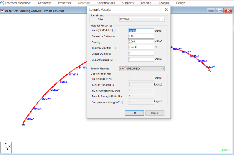

EDIT: Below is changed because I misunderstood what you are using. Please confirm you are using structural steel. I can't read your input. The modulus of elasticity appears to be 1E+08 kN/m^2.

E=Modulus of Elasticity (I used 14,503 ksi in my calculations, based on your input above)

Comment: this thing is mighty slender. Are you sure it's a 0.01 meter x 0.01 meter cross section? That's essentially nothing. What is this intended to do? (Sorry if you have already said and I missed it.)

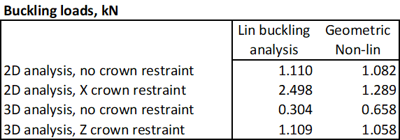

Checking my graph of buckling factors, I noticed I had actually used the horizontal half-span in the calculation, rather than the radius. Since the values from the paper used the radius I have updated the results so they are comparable. I have also removed the line for supports with moment restraint, since the analysis in the OP is pinned at the base:
Note that my results (blue line) are for a 2D analysis and the paper results (green line) are for a 3D analysis including out of plane buckling, with no torsional or warping restraint at the base, and no restraint at the crown.
My results for the structure as posted by Saedhaltech are:
The base supports are pinned for moments about the Z axis in all cases, and fixed for moments about X but pinned for Y and Z for the 3D analyses.
The loads are all point loads at the crown that will cause buckling, with no safety factor.
Unlike column buckling, the applied loads cause large deflections before buckling, such that the geometry at the buckling load is significantly different to the unloaded structure. This accounts for the difference between the linear buckling results and the non-linear analysis.
Also note that all analyses assumed linear elastic material behaviour. Except for the 3D analyses with no lateral crown support, the material would become non-linear well below the calculated buckling load.
