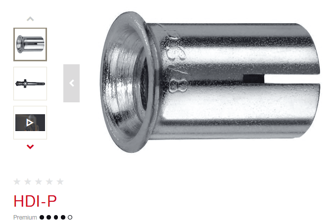

I like Hilti HDI-P. 400 lbs allowable @ 3/4" embed. The catch is that they're only for uncracked concrete. Given that they're pretty much designed for prestressed plank, I'd feel pretty good about saying their fine for PT slab for most applications as well.
Would ideally use a cast-in insert such as the Hilti HCI-WF where supports can be located with a reasonable degree of accuracy or loads exceed the capacity of drop-in anchors. For post-installed shallow anchors we’ve switched from Hilti HDI-P to Dewalt Mini-Undercut+ as it’s the only shallow embedment anchor that has code report approval for seismic loads in cracked concrete that I’m aware of. For post-installed applications with heavier loads we use expansion anchors and x-ray the slab to avoid tendons.

Thanks for the heads up on the HDI-P and Mini-Undercut. Those must be so new that THIS revised bulletin issued in 2017 still does not recognize their use even with the ESR having IBC 2018 (not the governing code up here, though).
The drill bit has a shoulder stop, so assuming they use it that should eliminate most of the risk of over drilling. What raised my eyebrow a little is the max torque you can apply after the insert is set: 5 ft-lbs. I could easily see a worker exceeding that when tightening up a nut with a wrench. What happens to the anchor capacity if it gets over torqued?
Nobody likes Hilti anymore... :) The mini-undercut is not a drop-in but as the name states it is an undercut anchor.
