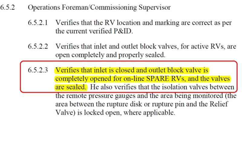

Dears
Find attached paragraph 6.5.2.3 from SAEP-318. Last week, during the site visit, we have noticed that a few spare relief valves downstream isolation valve in closed position and requested operations to open it. They are asking us, why this requirement mentioned in this procedure and is there any reason behind this?
Waiting for your advice..

"Discharge block valves on spare relief valves shall remain open to prevent possible overpressure of downstream lower class piping due to upstream block valve and PZV leakage"
