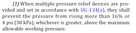

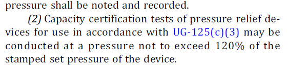

@The Obturator,
You are right to a great extent, but please see below:
UG 130 (c)(2)
And UG-125 (c)(1)
So 16% overpressure is acceptable for multiple PSVs as you rightly indicated.
The capacity certification tests can also be done at max 120% of MAWP.
The question is, if the existing PSV is tested @110% overpressure(assumed), will it require another certification test @116% of MAWP?
I feel existing PSV need not be recertified and capacity @110% MAWP can be used as available capacity from PSV1 and the required balance capacity can be taken from PSV2 @110% of set pressure(10% overpressure). This is expected to be conservative as we are disregarding the additional capacity possible from PSV1 for changing from 10% to 16% overpressure.
I am from power plant background where max. overpressure is 6% and I feel uncomfortable with 16% or 20% overpressure.

You are again referring to extracts from an out of date ASME VIII document.
Also you're still confusing the issue. Capacity tests at 'up to 120%' are for the relief conditions specifically mentioned in (old) UG-125 (c)(3). You seem to be picking out sections to suit your narrative. What exactly is it that you disagree with the comments I made earlier that are referenced back to ASME XIII and API-520 latest editions? If you don't like what is written is ASME, I suggest you contact the relevant ASME Committee with your reservations.
Please refer to ASME XIII which replaced all of these sections in 2021. If you need to make further comments, please start a new thread as this is now diversifying from the OP's questions.
I suggest you acquaint yourself with ASME XIII (2023), and the recommended operating conditions in user standard API-520 Part I (2020), before commenting again.
