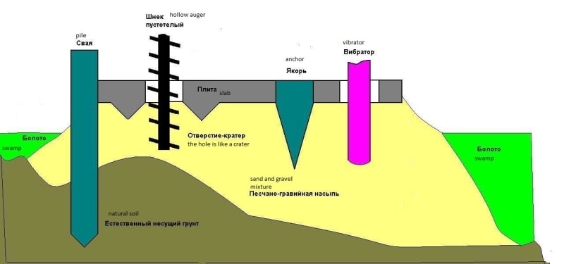

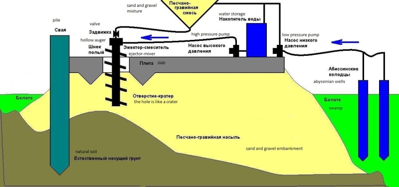

We are a family of four graduates of Bauman Moscow state technical University. We have been drilling wells for water since 1996. Our successes are in ( New to drillers: reliable downhole filter and auger pins.
We are exploring a new way of drilling roads on the swamps. (The construction of maintainable roads on weak soils). See details in .
We want to know your opinion about this method.
We are interested in cooperation.
Thanks for your attention.

I don't mean to be rude, but the fact that your diagram is labeled in Russian means that it is likely unintelligible to many of the professionals that check these fora. If you updated the labels with English, I think that you would get a bit more traction...
You're right! I apologize and correct myself.
On images:
1. Water is the cheapest means of transport. If there is one.
2. We want to replace weak soils from under the plate, for example, with a hollow auger. If necessary, the vibrator compacts the sand-gravel mixture under the raised slab as an imitation of a tamping machine. The anchor resists only horizontal forces. Pile-fence is made in any version, if it is necessary. The hole-crater is an example of the roughness of the plate.
3. Tamping machine
I understand that you are wanting to create a road embankment in areas with very poor soils, but I do not readily understand the method from your images. Could you provide a bit more of a step-by-step of your proposed process?
I suggest looking at the English text in . I wrote it a long time ago. My English is bad (there was no need). So I need a long time to think again and write a new text. I will try to write well.

May I ask what is the advantage/benefit of your method compared with the existing proven method by sheet piling, similar to building a cofferdam?
I don't know!
But I hope for the correctness of the classic set: low price, reliability, durability, maintainability, environmental friendliness.

That's the main problem that people don't response to your letters. Any new idea needs to clearly state its purpose (you did), and why people shall spent time to evaluate the idea (you did not). So you still have a lot of things to do, like finding out existing technics that compete the same market as yours, then in what ways your idea/method is superior to the others. Good luck.

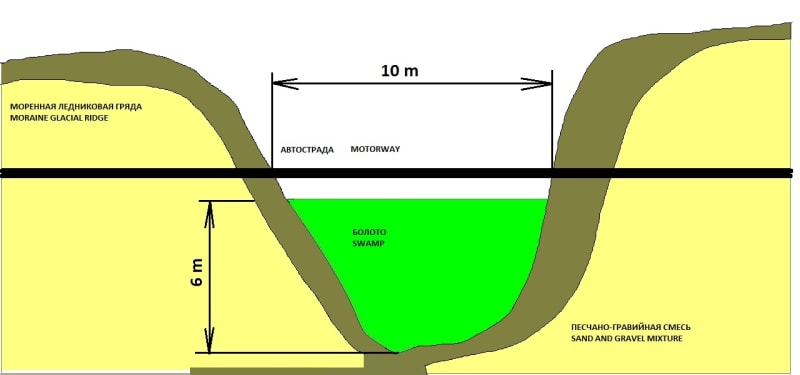

In the North of the Moscow region there is an abundance of glacial moraine ridges, in the lowlands of which there are swamps as in the picture.

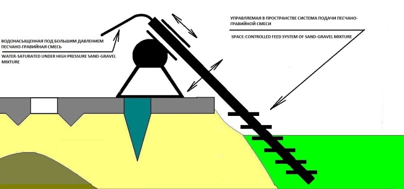

Let's compare the discussed method of construction of a 3-meter-wide road in a swamp with two known ones: the construction of bored piles and the classical one.
Which method is the most high productivity?

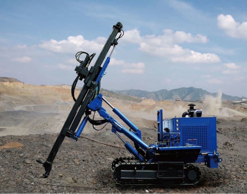

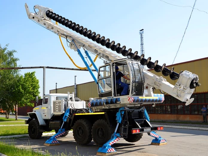

1. We will make changes to the Soviet drilling rig SBSH-812. I assume:
- the augers will be hollow, the diameter is 800 mm, the diameter of the auger pipe is increased, the size of the ribs is reduced,
- the mast will be able to work at angles of 45,..., 90 degrees,
- the water-saturated sand-gravel mixture is fed to the auger at a speed of 1 cubic meter per minute under a pressure of up to 50,..., 200 meters of water column.
Then the injection time of the embankment with slopes on the site of the swamp will be equal to 180 minutes. The work will be done in 1,.... 2 working shifts taking into account the time of moving the equipment and its maintenance. Then I can lay perforated slabs. My calculations may not be accurate, but they do not contradict the laws of nature.
2. The second method is the construction of eight bored piles in two rows as supports of a single-span bridge (without overlapping and grillages). The diameter of the piles is 400 mm, the length is 12 m.
The time for concrete to harden is several days. The laws of nature do not allow you to do the job faster.

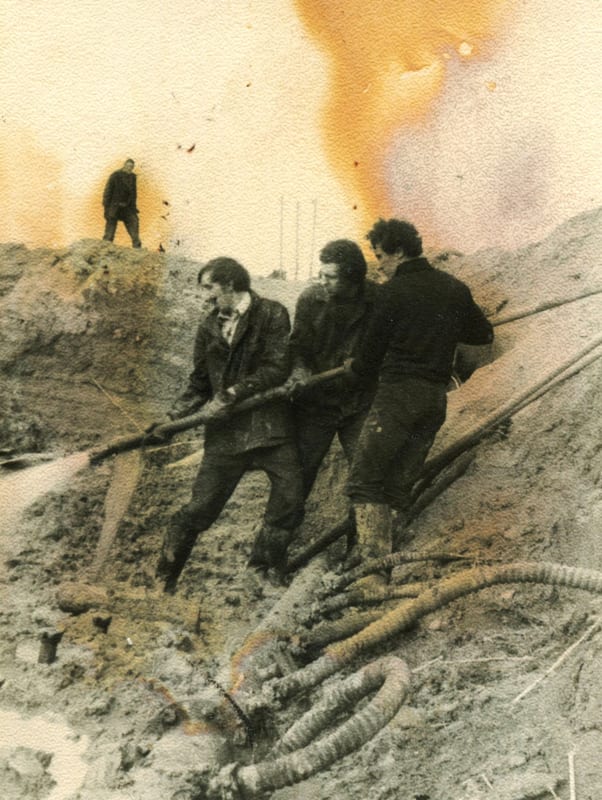

3. Classic. Water is removed by wellpoints (my experience in the USSR is in the picture), peat is removed mechanically, an embankment of sand-gravel mixture from the nearest ridge is built mechanically. Pumping water will take several days with pumps of any capacity. The laws of nature will not allow otherwise.
Qualitative assessment.
1. The mound is stronger, more reliable than piles, because distributed systems are more stable than concentrated ones.
2. The discussed method can be well automated (robotic). Manual labor is small, the technology is monotonous, measuring the loads on the auger and water pump will allow you to study the soil of the swamp.
3. The mound is compacted with water, not a vibrating roller.
4. The volume (diameter) of the injection of sand-gravel mixture may be larger than the diameter of the screw (injector) due to the weakness of the substituted water-saturated soil
For clarifications it is necessary to try to ensure high productivity.

After all, I am not familiar with drilling operation, but "hydraulic drilling" sounds familiar to me. Also, perforated slab been utilized in many hydropower projects around the world.
Instead writing thesis, have you tried your method in any project to proof the advantages you claimed? I suggest to start locally, looking for small scale projects. Success will follow your achievement in real applications.
Thanks!
You wrote: «Also, perforated slab been utilized in many hydropower projects around the world».
I ask for examples of the use of perforated slabs in the world. In Russia such slabs were not used, but theses about perforated slabs were written in Siberia. In Russia, I did not find support even as a discussion. This forum is the first discussion for me. I don't have enough knowledge about soil mechanics. I will once again try to attract the attention of Russian engineers to the problem under discussion. Perhaps your reasoning will help me.

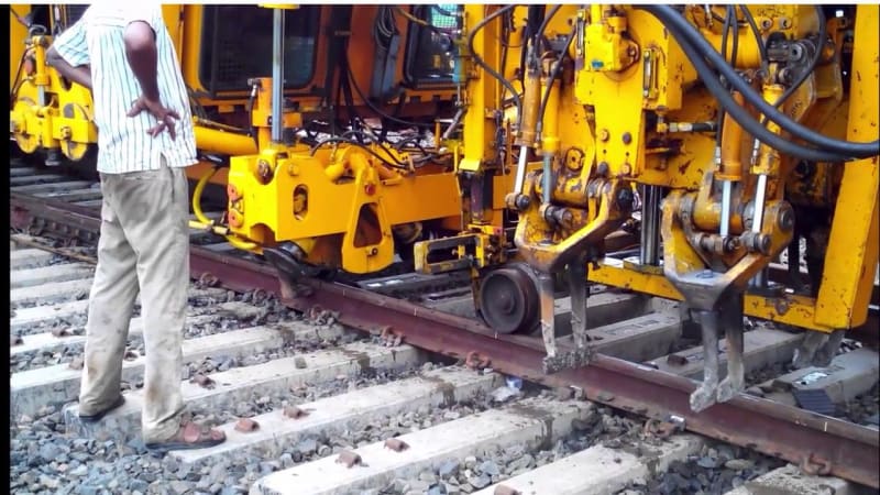

I compacted railway embankments with a vibrator while on vacation in the USSR. In 2016, I successfully compacted the soil under the slab (see picture) with a Chinese vibrator. I can't buy and remake the МБШ-812 drilling rig to continue the research.
