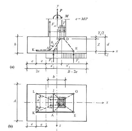

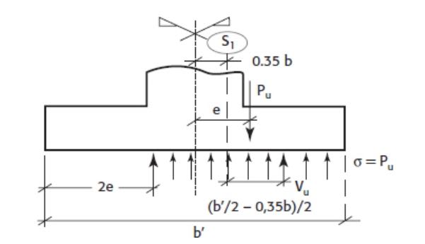

I'm studiyng shallow foundations with trapezoidal or triangular pressure distribution. I have to calculate reinforcement with this non uniform distribution but here are extracts (from french books) of pressure diagram used for it:
-Reinforcement with strut and ties's method:
-Reinforcement with bending moment's method:
For both methods, hypothesis of soil pressure is the same: it is a rectangular diagram. How is it possible to take this hypothesis if the cross section of the footing was previously designed with a triangular or trapezoidal pressure distribution ?

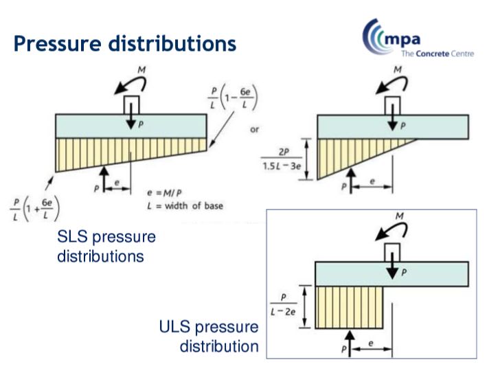

Here is another extract from an english document which describes the diagram of pressure distribution for each limit states:
But i don't know how this choice is justified?
Thank you for your help.
RE: Shallow foundations: distribution of soil pressure with Eurocodes
If you noticed and understood the difference of the two abbreviations describing the pressure diagrams in the last graphic, you shouldn't have puzzled over which method is justified for 1) bearing pressure checking (an exact analysis), and 2) footing reinforcing design (an approximation/simplification to produce most conservative design). Make sense?

In my opinion, there's no contradiction in using different diagrams for SLS and ULS conditions as the strain level is fundamentally different. More or less like RC section analysis, where you use a triangular stress strain diagram for service conditions and a rectangular stress block for ULS design.

I see your discipline is "geotechnical", so you understand well that soil never behave in any way "linear", nor "uniform", therefore, both diagrams (of SLS and ULS) only represent the best approximations that are quite close to the ideal responses of soil, yet remain easy for computation purpose.
The structural engineer like to think the soil is an elastic medium, thus, under service load, the stresses are derived through p = F/A +/- M*y/I, the resulting pressures are linear in forms of triangular or trapezoidal shape. The pressures are consider the exact (not true) solutions of the given conditions, they are then used in calculating the resultant force (R), determine its location under the footing base in contact with soil, and finding eccentricity (e) between the applied load and the resultant force. The maximum pressure and resultant force are thereafter to be used to check the serviceability requirements - namely, bearing pressure, overturning stability, and shear friction between footing-soil interface. This analysis method used to be called "limit equilibrium method", now is more clearly named as "service limit state" (SLS).
Although the primary usage of pressures stated above is checking serviceability, there is nothing wrong to use the pressures in design the footing depth and reinforcing. The dilemma lies in how to properly apply load factors as required in reinforced concrete design by ultimate strength method, a long heated debate I don't want to bring it up in here again. Thus, the uniform pressure distribution is a simplification that more suitable for the purpose of footing design (thickness and reinforcing). The name "ultimate limit state" (ULS) states its intend application clear and loud.
