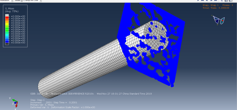

Hi. Im trying to simulate crushing of a porous material by using SPH in abaqus. I've imported the porous material from an input file, and the porous material is based on PC3D particles with an orphan mesh. I've also created a cylindrical rigid body indenter which acts as a piston. The rigid body is assigned with a reference node at its bottom face, which is given some initial velocity so that the indenter will press the porous material during the analysis.
The problem with my simulation is the following: instead of compressing the particles, the rigid body penetrates completely into the structure. I tried to create a node-based surface as suggested the abaqus documentation (Link[/url]https://abaqus-docs.mit.edu/2017/English/SIMACAEMODRefMap/simamod-c-nodebasedsurf.htm#simamod-c-nodebasedsurf-t-CreatingANodebasedSurface-sma-topic1), but when I ran the model I encountered the error: Node-based surfaces are not yet supported in Abaqus/CAE, and abaqus automatically converted the interaction setting to general contact with all*. I would be massively grateful if anyone can give me some pointers to solving this issue.

For your reference, here is a screenshot showing the particles penetration when the indenter moves

I thought that your original orphan mesh consists of solid elements and you want to create particles from them. But if you already have particle mesh then you have to follow the steps described in my previous post with some small changes (omit the part regarding solid mesh). So most of the setup must be done in the input file where you can define node-based surface.
The problem is that even after I’ve defined a node based surface in the inp file (*surface, type=node, name=surf, nodeset) the cae converted it back to node set with the following error: node based surface is not supported in abaqus cae.
I then tried to bypass abaqus cae by running the job from the command line and then view the odb file in the abaqus viewer. But the output file didn’t run in the viewer...
That’s right, you have to omit CAE when you define node-based surface in the input file. So just run the analysis from command line, as you say. When you do this are there any errors generated ? Aren’t the analysis files empty ? And does it say completed anywhere (in the command line or analysis files) ? There might be some error in the definition. Make sure that all necessary definitions are specified in the input file (step, material, section and so on).
