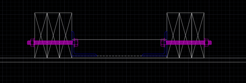

Balconies are aluminum both julliene and full size. They attach by a ledger at the building and steel rods back up to the framing.
I was curious if anyone has dealt with these companies. The show an an attachment plate with a couple of holes in it and the rest I believe is going to fall back to others (EOR) The attachment to a wood stud is the weak link which the architects dont seem to notice. For an average deck it is in the range of 3K.

A MEDIUM SIZE BALCONY @ 60 PSF LL IS ABOUT 2-3K WITH DL, PULLING AGAINST NOT A 2X6 STUD WITH A COUPLE OF 8d END NAILS, NEEDS THROUGH BOLTS LVL POSTS AND BACKER PLATES

BSE05 - sounds like you worked out a solution, or at least part of one. How about an LVL/PSL post with an angle on the side through bolted to the post. Then the rod attaches to the angle and the whole connection takes place within the depth of the wall. Or, you can do two built up posts (2 or 3 2x6's each) at 16" o/c and run a steel channel between them with the web flush with the face of stud.
You mean something like this---> Link
Not a horrible idea, but I can only imagine how many different manufacturers there are, and how many different ideas they have. The lessening of redundancy would be a concern. Pharms' idea is the route I would consider.
