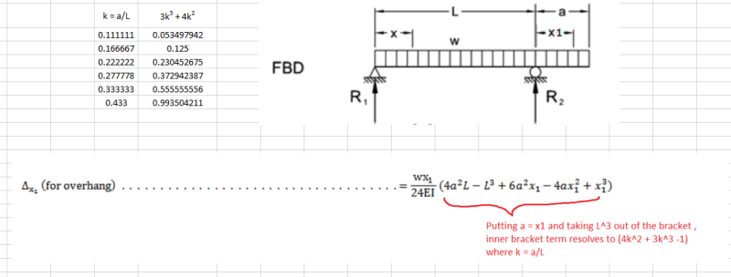

I'm working on a bit of a guide to good balcony design (for waterproofing purposes) in these buildings, and I've got a theory, which might be totally out to lunch (which is why I'm checking).
My theory is that, in buildings with suspended concrete slab construction and cantilevered balconies, deflection of the slabs due to dead load and occupant loading inside the building might actually cause cantilevered balconies to deflect "up" (I'm sure there's a proper word for that).
The reason this would be meaningful is that balconies are often poured with a very slight slope outward, presumably for drainage, but we often find balconies don't drain properly, and I'm wondering if this type of reverse deflection might be part of the reason.
I've done a quick sketch of what I mean.
If this is out to lunch, let me know!
But if it's not out to lunch, then how much extra slope should we put on the balcony slab to allow for this deflection? 2%?

Good guidelines ! I went back to re-read your post and noticed that you mention your projects being high-rise. How tall are your buildings typically ? If 40 storeys or more, column shortening might also be affecting the overall deflections.
A quick and dirty way to check - Are the sloping issues more common on the upper storeys than the lower ones ? I ask because column shortening effects are more pronounced in the upper third of any tall building.

Most of the high-rises we deal with are in the 30--40 story range - and I think generally we've seen leaks on lower floors.
Would columns near the interior of the building be more likely to shorten than those around the exterior?
The columns with the highest permanent load stress will shorten the most.
