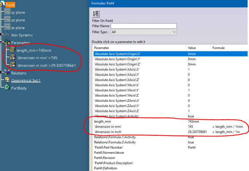

Formula problem
Alan Lowbands
Aerospace
May 17, 2017
274
Could anyone please tell me how I get this formula to show the first 3 results in inches ?
I still need the length in metric.
ToString((`BOX SECTION H` )/1mm) + " x " + ToString((`BOX SECTION W` )/1mm) + " x " + ToString((`BOX SECTION WALL` )/1mm)+ " x " + ToString((LENGTH )/1mm)+"LG"
I just can't sus it :(
regards
Alan
Thanks Costinruja,
Tried that but its doesn't seem to make any difference ? :(
Do it in a test part.
It might be a settings problem, but which one I don't know.
Best regards,
Costin Ruja
