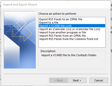

You are right. I completely missed that instruction at the bottom. lol
However, now I am lost because the only way I have found to import is through FILE > OPEN & EXPORT > IMPORT EXPORT
Then this window pops up.
I cant seem to figure out what to click to import those files. Whatever I click seems to not see those files.

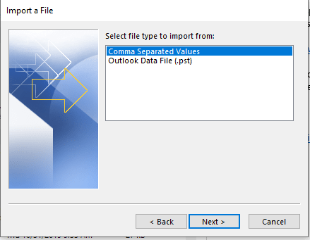

If I click on IMPORT FROM ANOTHER PROGRAM OR FILE ... It then gives me this window and neither seems to work....
Alt+F11 toggles between the application interface and the VB editor.
In the editor, view the Project.
In the Project tree, right-click to import modules and userforms.

LOL I can be so much a fool sometimes! lol I knew that with excel. I use ALT+F11 all the time for that. For some reason it never even popped in my head that it would do the same thing for Outlook. lol
Skip, you never seize to have the right answers for me. Whether for God or code. Thank you once again. [smile]
