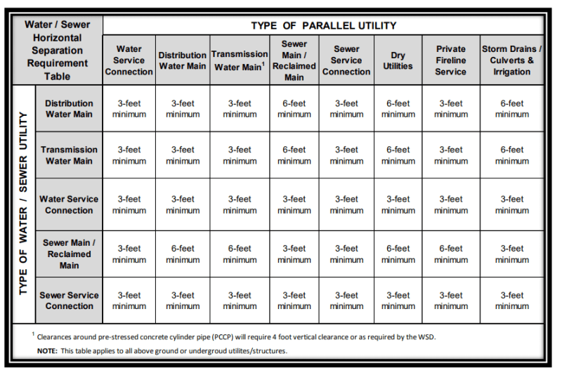

Help check the sewer contractor. What rules should apply to the network? distance to running water, electricity, of buildings, network of slopes and the distance between catch basins.
assuming storm drain, not sanitary sewer and not building drains
[ul]
[li]running water = underground water pipes? = they could go in the same trench, but better to maintain a few feet separation[/li]
[li]electricity = underground cables = should be encased and can go above storm drain pipes. generally are not buried deep enough to go under[/li]
[li]buildings = storm drains should not go under or next to buildings[/li]
[li]slopes = drains should flow fast enough to carry sediment but not so fast as to create high pressure surges or erosion[/li]
[li]catch basins should be spaced to capture water such that flooding does not occur[/li]
[/ul]
"a distance of a few feet", "should not go under or near buildings" is how many feet, is there any minimum?
these are generally building codes, laws or ordinances. if you dont have any local codes, than you will need to use engineering judgement and set your own. these are usually based on maintenance requirements.
here is one example
Thanks a lot, that's what I need!!! Please tell me the source of this table, I will look for local analogues.
city of phoenix
