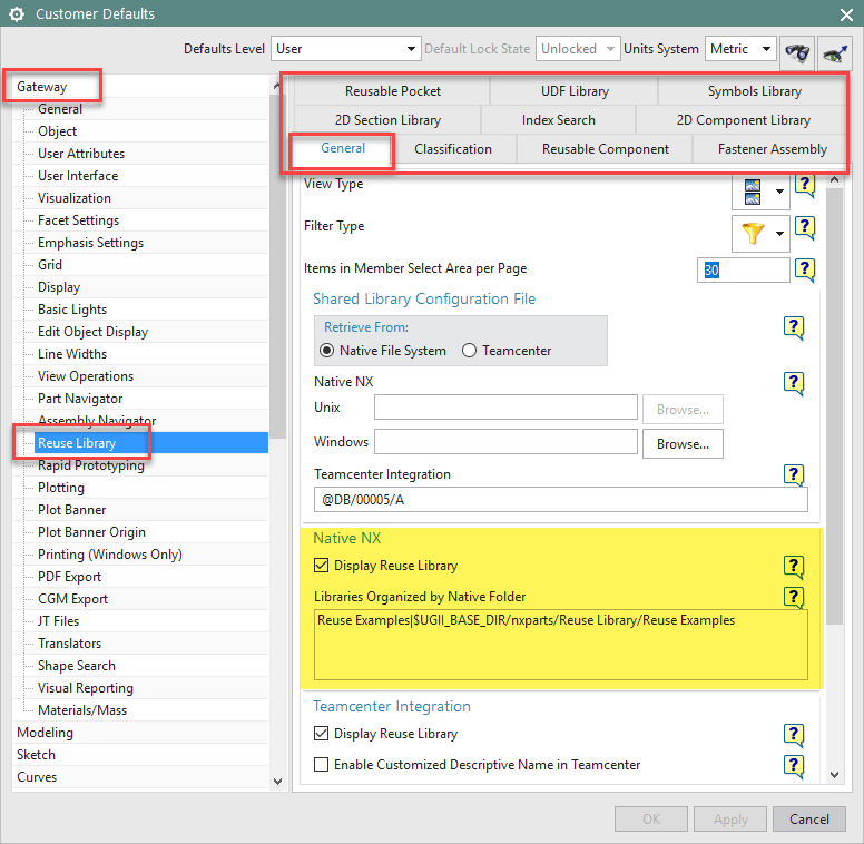

Defaulth fastener part located in system catalog in "Reuse example". How change it and indicate path to my own catalog?
Thanks.
File- Utilities-Customer defaults :
Add new lines for separate libraries .
Syntax :
"name-of-folder-in-NX" | "\\server\directory\directory"
example:
ISO Library|B:\NX\standard\ISO
DIN Library|B:\NX\standard\DIN
Regards
Tomas
