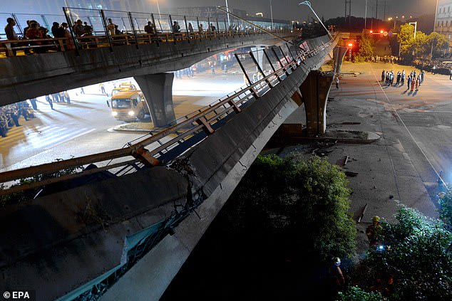

If the span was routinely operating in a high (overloaded) stress range then fatigue comes to mind. In the video you can see the span deflect and rotate as the trucks pass.

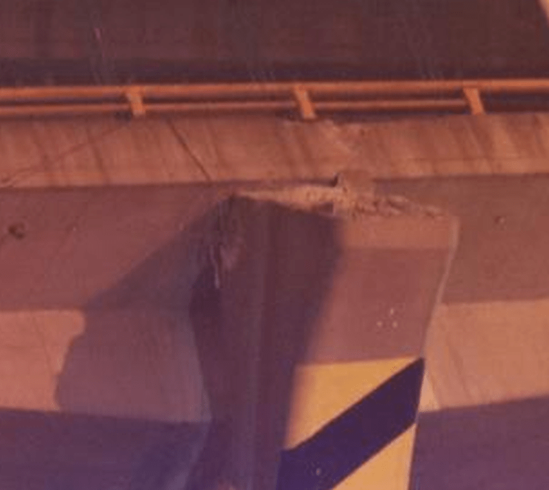

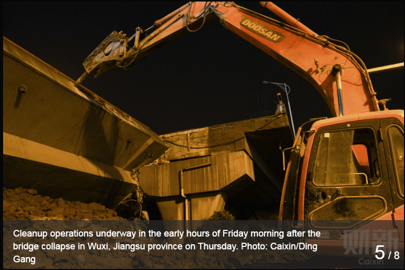

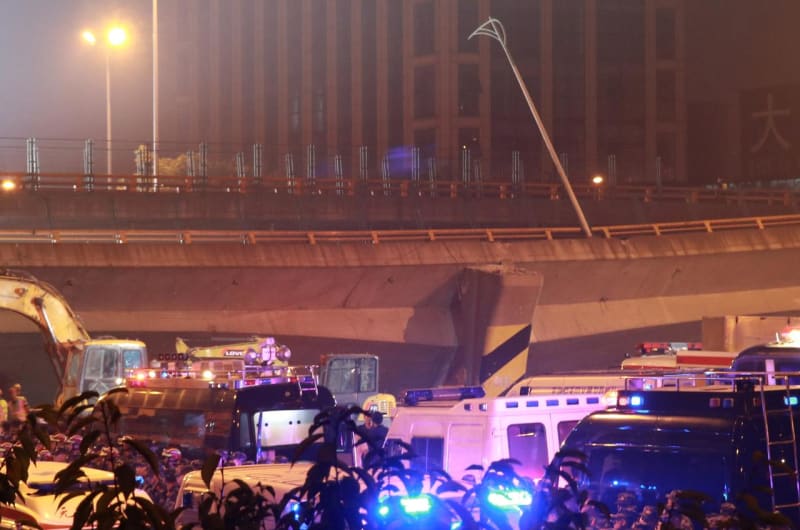

The surviving span shows an unusual support, where the flared corbel at the top of the beam doesn't actually do anything structurally, the span sits only on the top of the beam. The second picture shows that the fallen span is essentially intact, as are its supports, confirming from the video that the span essentially tipped off its supports. That doesn't appear to be a proper design. A further image shows that one of the supports has lost its little tip-top, suggesting that was the point of failure, which resulted in the span rolling inward toward the other span as its support post disintegrated

I’m not a bridge designer but I don’t see how torsion on the span is resisted when there’s only a single bearing centered on each column. And with the flared shape of the column you would expect to see a pair of bearings, yet I only see one in the photos.
Correct that there is little torsional resistance. As well, it looks like the overpass is on a bit of a curve, which wouldn't help.
That pier in above photo actually has two bearing points. Seems like that might have been what they were reliant on to take out the torsion if there was no end built into the abutments.
I wouldn't say its totally unusual to just have a single bearing on a box girder, especially if it's curved you can get some stabity out of it at larger curvyness and there's some means of resisting torsion forces at some of the supports. It looks pretty straight to me though.
Perhaps there is typically heavy truck traffic on this route traveling in one of the lanes exclusively. That could have caused excessive fatigue on the single bearing if it’s constantly being loaded eccentrically.
Didn't seem to be a plausible design to me. If both lanes are equally loaded at all times, that's great, but if one lane, then the other, gets loaded, the roadway will rock on its support, thereby fatiguing both any metal (not evident in any picture to date) and the concrete.
